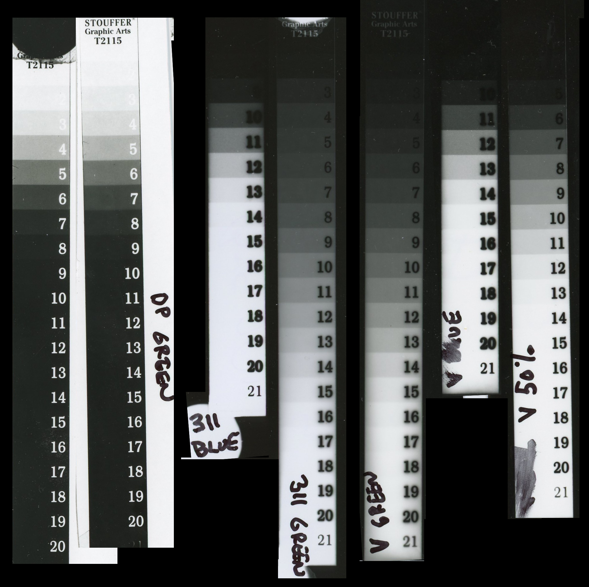

Here is my tests with Stouffer wedge (311, MGRC and Harman direct positive):
I haven't seen any problems with whites on 311. Maybe your paper got fogged or the exposure wasn't correct? Looking at the picture it seems to be a bit overexposed / a bit lower contrast than MGRC.
On high contrast (blue) there isn't that much difference in terms of characteristic curve. But on low contrast (green) the Ilford seems to be much linear on shadows.
