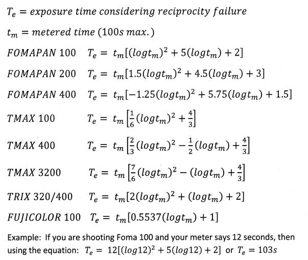

I use the attached formulae.
I precalculated metered time vs. actual time, then printed it out for field use.
BTW, the rated speeds for Foma films tend to be too high. I generally halve them.

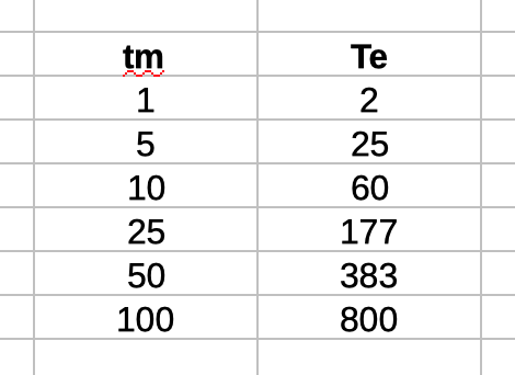

Huge thanks for the formulas! I calculated few values with Foma 400 with those values, see attachment. Do you mean you measure the original exposure with ISO 200 setting and then calculate reprocity from the time you got from ISO 200 exposure?
I think Foma 400 blows the highlights pretty easily so I have not been too keen to overexpose it. Probably it's just not possible to prevent the highlight blowing so just save the shadows! :smile:
