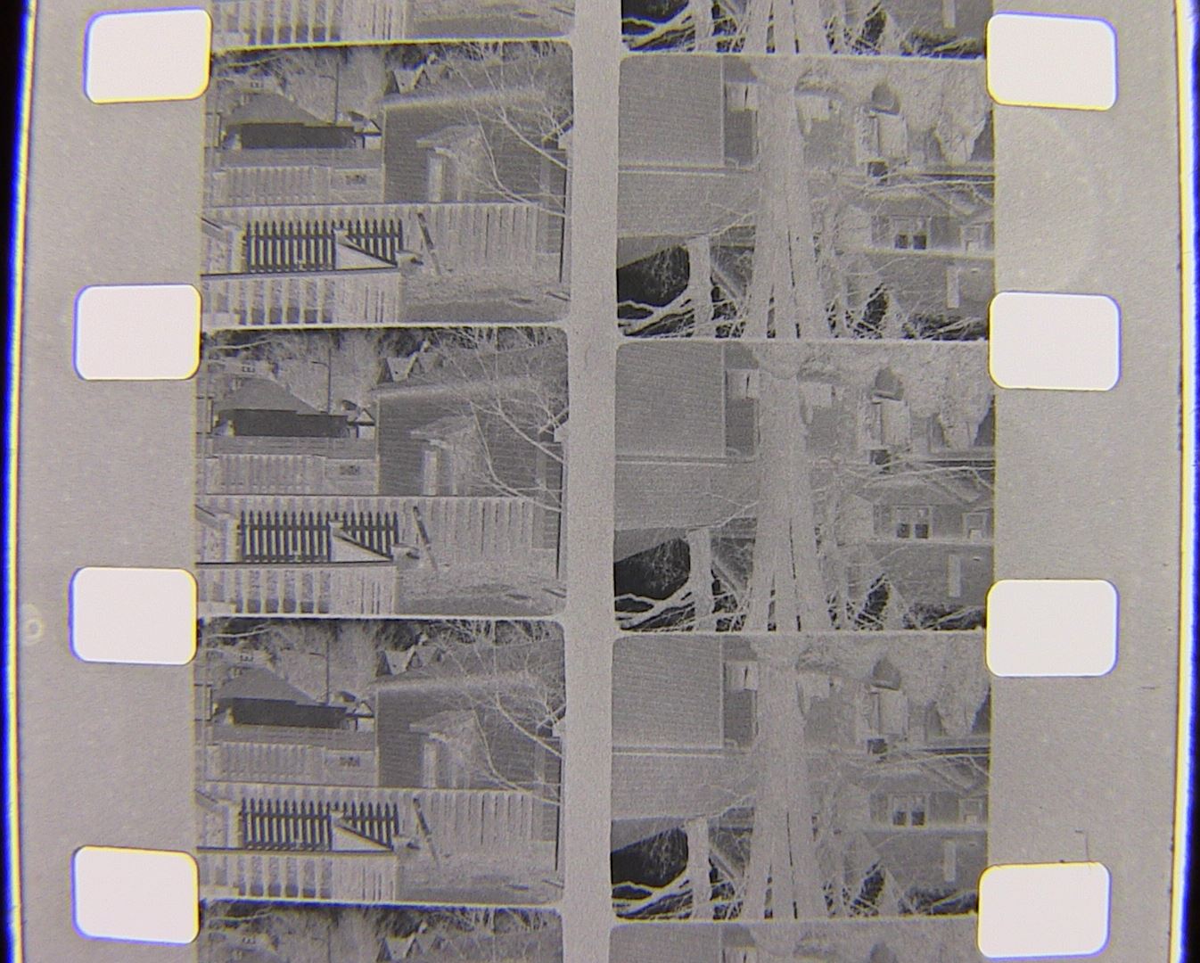

studiocarter
Dec 19, 2008
437
Pittsburgh
Fomapan R100 bleached first developed to negative second
studiocarter
Dec 19, 2008
437
Pittsburgh
I was racking my brain about this and it finally came to me a couple of weeks ago, and I just tried it out.
First, bleach (I used C-41 bleach) this removes the anti-halation layer but leaves the latent image alone, as it has not been developed yet.
Rinse
Develop
Fix
Enjoy negativity :smile:
Thanks
Apr 10, 2018
35
Geneva
View attachment 198688 Fomapan R100 bleached first developed to negative second
Very nice ! So you used the Foma bleach (dichromate based according to http://www.foma.cz/en/fomapan-R-100) first then processed as normal negative film (dev/stop/fix/wash) ?
Or mixed your own Permanganate bleach ? If so, with sulfuric acid ? In with dilution, time, tmps, etc ?
Thanks very much, the hydrogen peroxyde and citric acid isnt very conclusive yet (bleach incomplete, stain on film) i think it's because my citric acid is industrial, i'm going to try with lemon juice soon.
Jérémy
