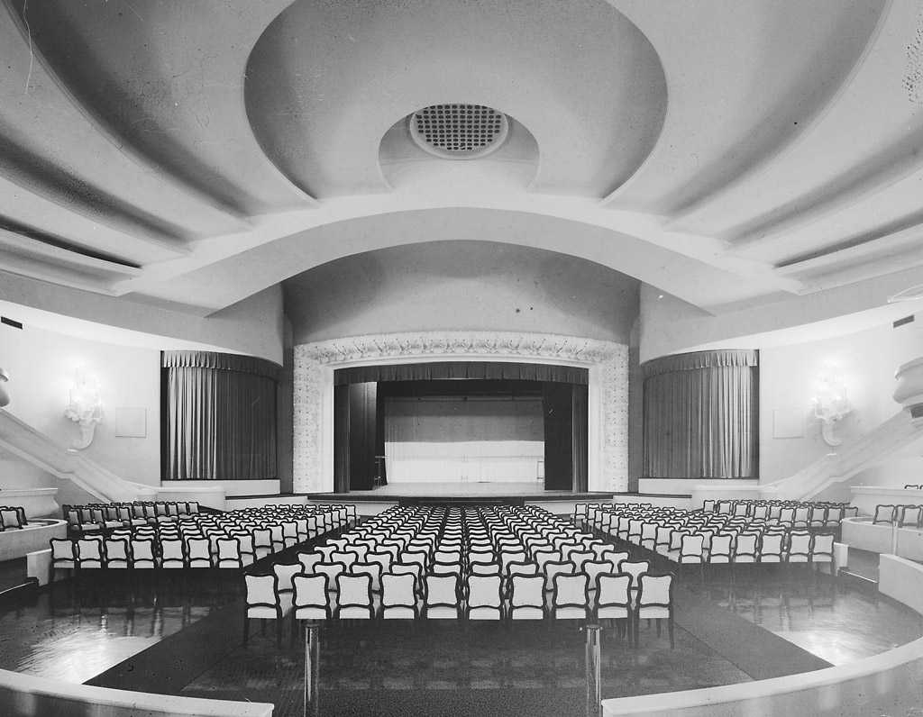

I've been using Fomapan 100 for some time now in 4x5" and I noticed these strange marks all over the photos from my last trip. I have to go back to my older stuff and see if there are marks like these, but I think I would remember if I had these before. Looks like some very small cracks... or maybe something like fungus.
I used a stop bath and, maybe, that's the problem, although I always used a stop bath. There are pinholes in the emulsion and I will try processing some sheets without a stop bath to see if they go away.

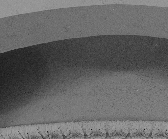

Look at this crop from above the stage:
The marks are stronger in some pictures and I can't see them with a loupe.
I looked at some photos I took with Ilford HP5+ and they don't show the problem.
Please, help me understand what's wrong.

I've read that whole thread and, from what I understand, the problem was never identified.
My marks look pretty much like those, but being on sheet film, they are pretty hard to see. My loupe is a 7x and isn't enough to have a clear image of the marks.
Looking at the film with a light source at an angle, I can't see any texture resembling the marks on the film surface. On the emulsion side, I can see the characteristic grainy texture. The base side is smooth and shiny, as it should.
Previous photos with film from the same box don't show the marks. This would indicate a problem with my processing technique, but I didn't change anything, except for the fixer: I used to use Kodak fixer (the only one they sell nowadays) and, since I ran out, started using homebrewed F-24.
I use a MOD54 in a Paterson tank and, when the ambient temperature is over 22°C, an ice bath is used to cool the chemistry to that temperature. I wash with deionized water (Ilford method) and, on that day, it was around 24°C. Some Photo-Flo and then hang the film to dry. The darkroom itself was around 26°C that night and I never use any kind of dryer.
Like said before, I used an acetic acid stop, which I intend to replace with a water wash to prevent pinholes. I have always used an acetic acid stop and can confirm there are pinholes in my older material (same box of film). The pinholes are bigger than the marks and much easier to see, even without a loupe, in the dark areas.
I am thinking about using a hardening fixer, since Foma emulsions are so easy to scratch.

The general image shows several defects.
In the crop, it seemed to me that there are serious faults “Y”, or the stars.
White spots appear I have not discussed.
White spots may came from developer impurities(Gerald C Koch said)
or dust from cutting and perforation of film.

@Gerald C Koch : developer is homebrewed D-76, prepared according to Kodak's published formula and filtered with a paper coffee filter. One of the pinholes is visible on the photo, to the right of the cropped area. White spots are dust on the scanner. These are not what I'm really worried now.
@georgegrosu : I can only conclude the marks are inside the emulsion. A better loupe or more powerful optical equipment would help! :smile:
