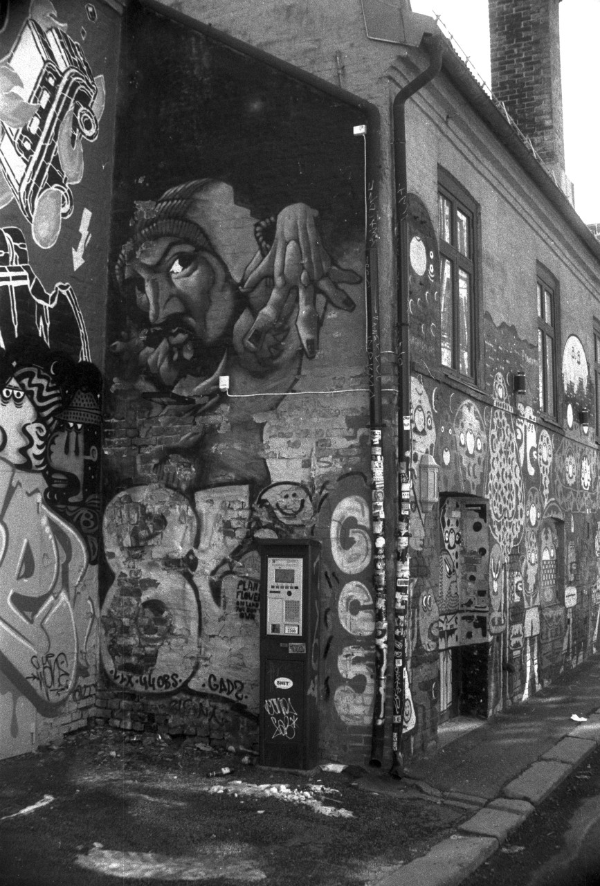

removedacct2
May 26, 2018
366
I got a FED-NKVD with defective rangefinder. I wanted to check the alignment of the lens, so I used a Blix external RF in order to focus with the distance scale of the lens, at different close range distances, 1m, 1,25m 1,5 2m, etc. Did that indoors, used two studio lamps, and load a short strip of Fomapan-400, metered at 400, in order to take few pictures with the old FED lens at 3,5 4,5 6,3 at 1/20s.
Just a test strip with 6 frames, and I was lazy to mix a developer, so I just picked a bottle of D-23 with 5g metol instead of 7,5g that I use with some contrasty 8x10 sheets and that has been replenished 35 times.
I didn't bother at all about the results besides checking the exactitude of the lens scale distance.
12mn, 1 mn constant agitation, then 10s every minute. With sheet film I do a 2nd bath with 10% borax, but for this fast little lens test I didn't.

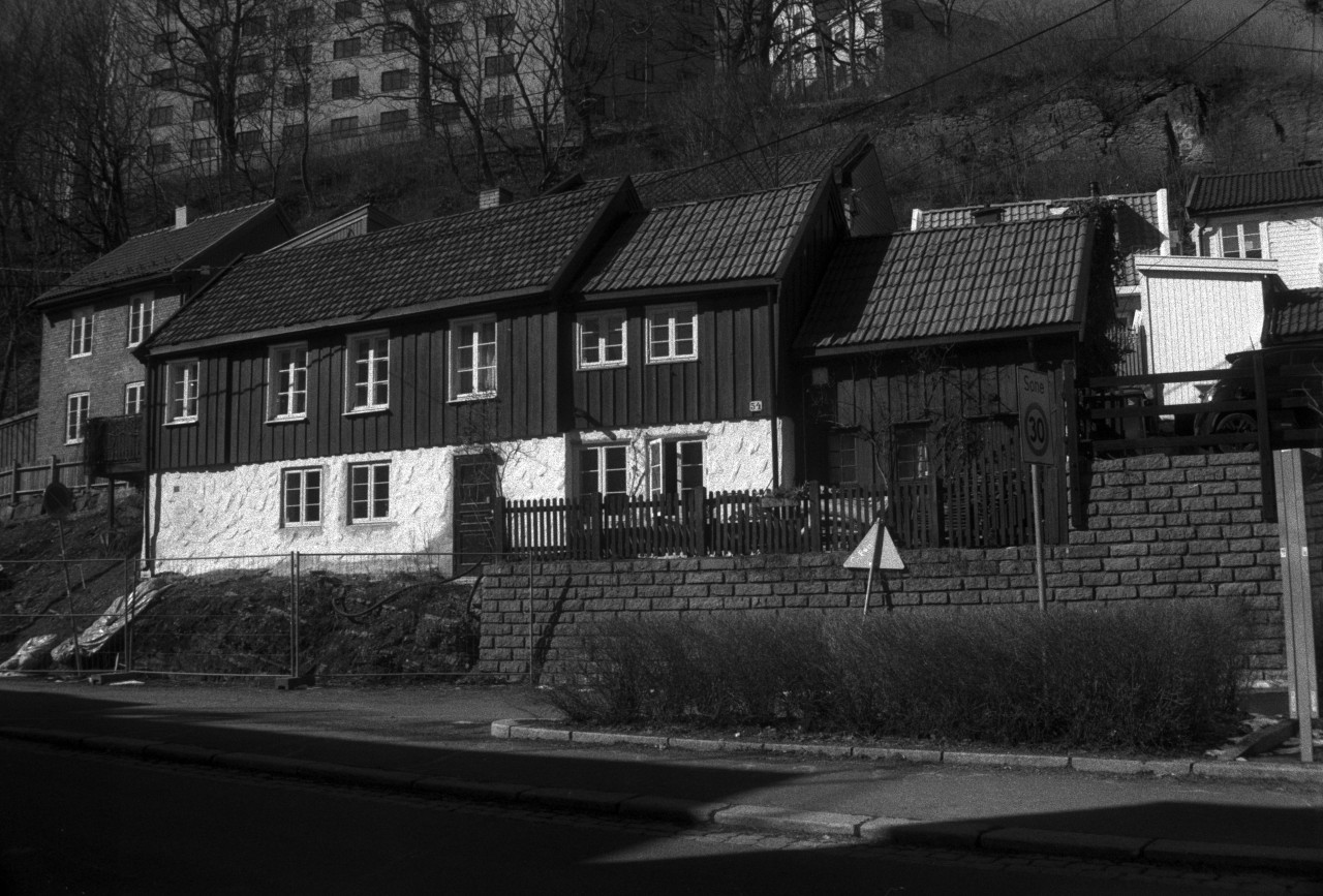

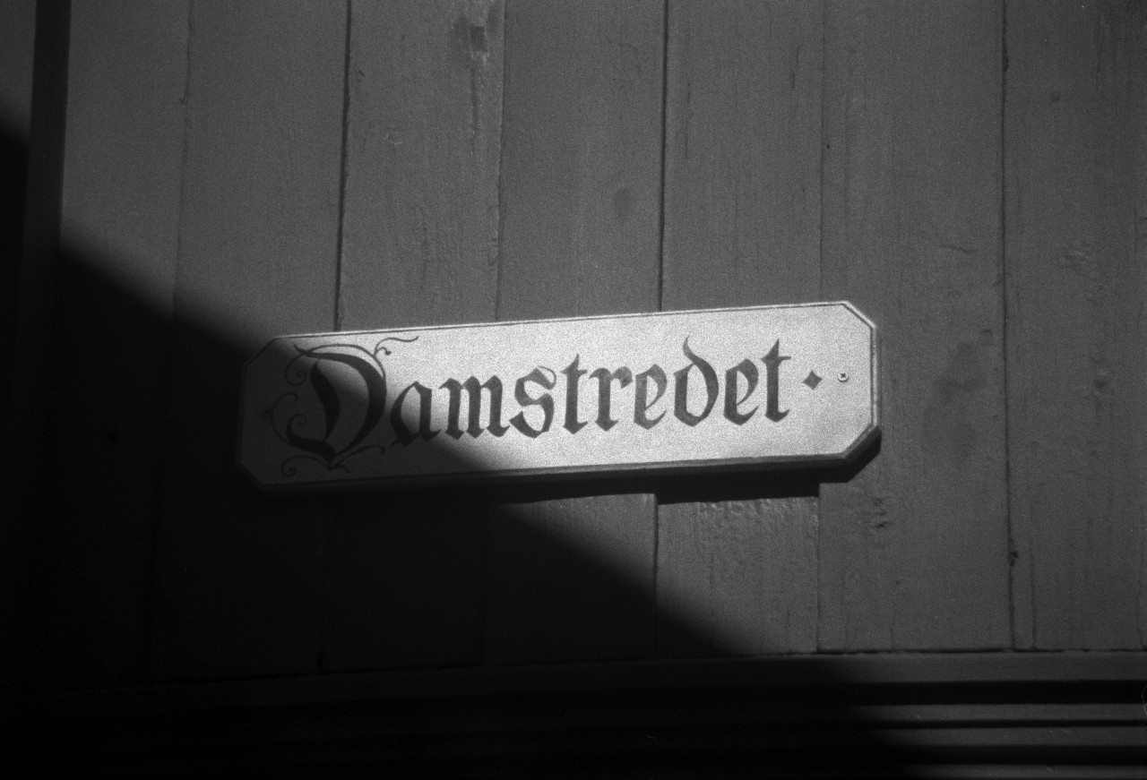

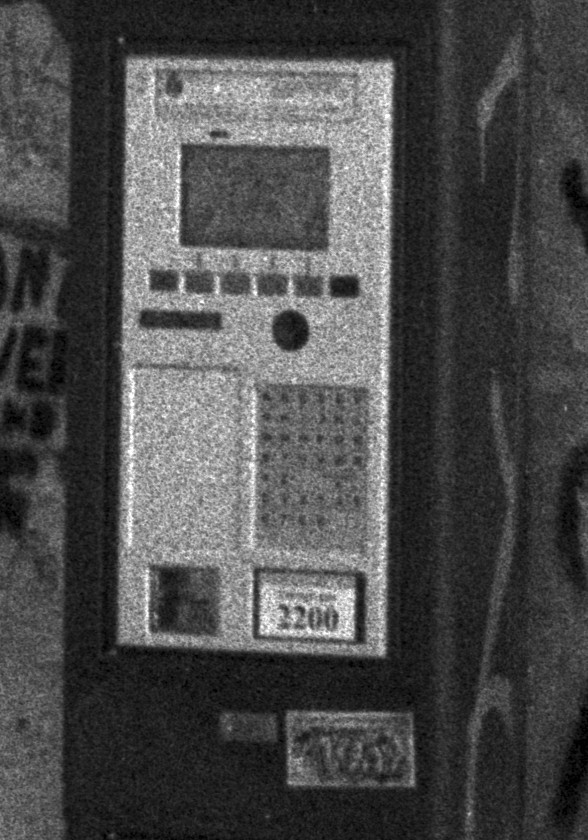

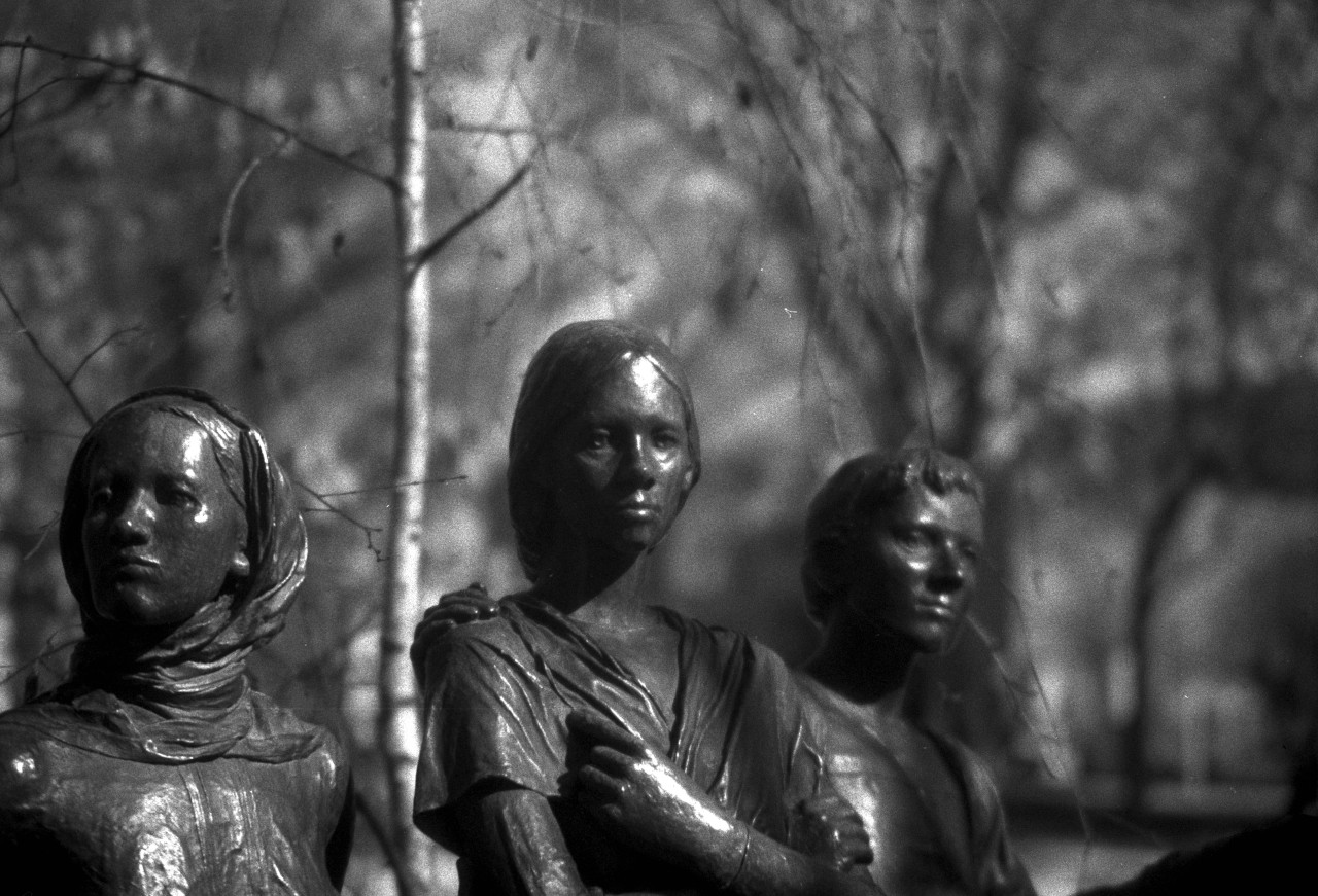

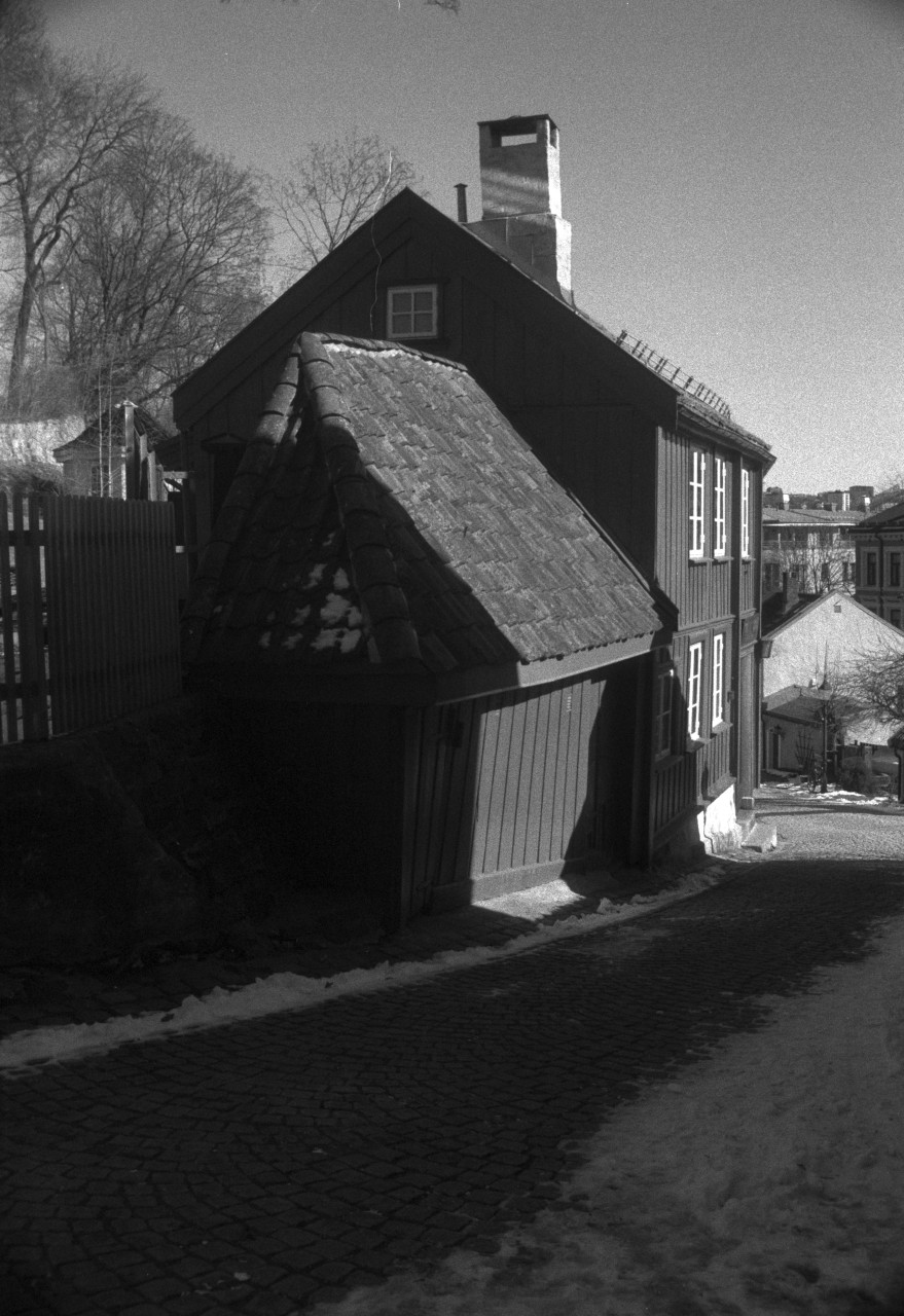

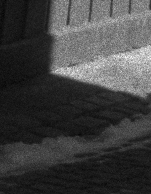

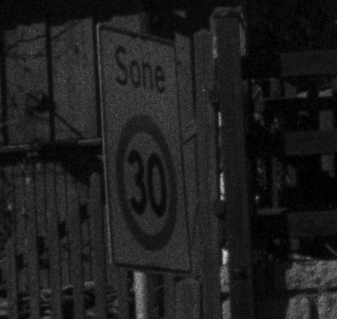

this time I tried D23 for itself with some Fomapan-400 35mm
Very sunny day, I was lazy to use a spotmeter , instead just the average metering of the CdS in a Ricoh Singlex II, with some 70's zoom lens 35-105mm
I metered for iso 250. Didn't follow development time provided by Massive Dev Chart. Instead, I opted for 10 mn of replenished D23 I mixed in june 2022 and replenished over 35x with DK25-R. 1st mn constant agitation, then quite energetic: 5s every 30s, then 5 mn constant agitation with 10% borax. I usually use two baths with sheets. not sure it has a real effect on small format.
some pictures, with a bit at 100%:
