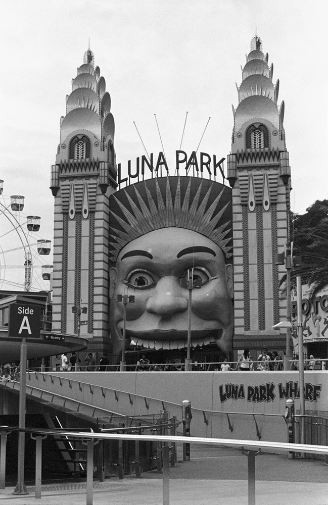

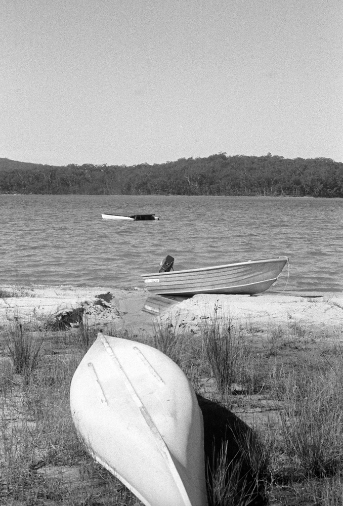

I've nearly finished a bulk roll of 35mm Fomapan 200 that I bought from a member here in mid-2014, expiry date was Nov 2016. Frozen before I bought it and reloaded into cassettes and refrigerated ever since.
Always shot at ISO 200 and had no problems with shadow detail. Our metering techniques will always vary from person to person. This film tends to be on the contrasty side and when processed in HC-110, Dil H (1:63) I had to keep reducing development times to try and save the highlight details. I find HC-110 to be a very active, even feisty, developer. Around 8 mins at 20C were my more successful efforts. I've shot it recently while testing cameras prior to sale and have been developing in D-76 at 1+1, 5.5 mins at 24C. High ambient temps in Australian summer time. I much prefer the D-76 negs - longer tonal range and finer grain than HC-110.
Regarding emulsion defects I have seen a number of irregular areas where it looks like the emulsion has been scraped during coating before the emulsion has hardened. Areas of low density in the negs which appear darker on the positive images. Not clearly defined but more streaky in their appearance and the marks run in various directions. Not a problem in camera or processing.
The first shot was processed in HC-110, 10 mins at 20C. Highlights were blown on most frames on this roll. Pentax S2, Auto Takumar 55mm f1.8, metered with Gossen Profisix and 7.5 degree tele attachment.
Next shot was processed in D-76 1+1, 5.5 mins at 24C. Better tonality and grain. Test shoot for Fujica ST605N Super Tak 55mm f1.8 that I'm prepping for sale.
I doubt that I will buy any more 35mm Foma 200 when I have finished my supply. Back to FP4 and maybe Kentmere 100 or one of the Adox products which are a bit hard to source in Aust. I don't really need an ISO200 speed film. 100 or 400 normally does all I need.
I do like the tonality of this image. I'll have to try a roll, and have it developed it in D-76.
tokam
Nov 7, 2008
594
Sydney, Aust

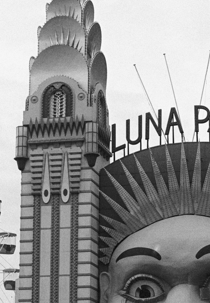

Have to bear in mind the different lighting conditions, slightly overcast in the Luna Park shot. I'm about to make up some Perceptol and I'll shoot one of my last Foma 200's and process in this for comparison purposes.
PS That Super Tak 55mm f1.8 turned out to be a lovely old lens. I have too many cameras / lenses. Time to de-gas.
Crop from 2000ppi scan, no sharpening ex scanner or in post.
