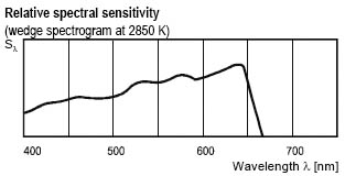

Foma 100 spectral response
In one of the previous posts I found information, that Foma 100 has reduced red sensitivity in favour of blue rays. Actually, the manufacturer's data suggests something opposite. See attached file. They don't explain however, how they measured that and what the term Relative Spectral Sensitivity means. Relative to what? I shot one roll 120 in winter and clouds were clearly defined on a blue sky.

Using the imperfect but objective RMS granularity scale, Foma 100 is 13.5. For comparison, T-Max 100 is 8, Plus-X is 10, APX 100 is 9. Human vision detects a difference of about 16%, so you can see that Foma 100 is two orders of magnatude there.
I have been shooting Foma 100 in 35mm because of the price; it's a nice film but definitely somewhat grainy.
Of course, with large format it's probably better than almost anything available 80 years ago even at 13.5!
