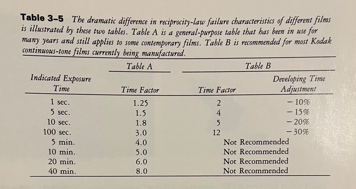

Personally, I never have, but this table in "Photographic Materials and Processes" by Stroehel, Compton, Current and Zakia (1986) does recommend an adjustment (sorry for the crappy phone capture):

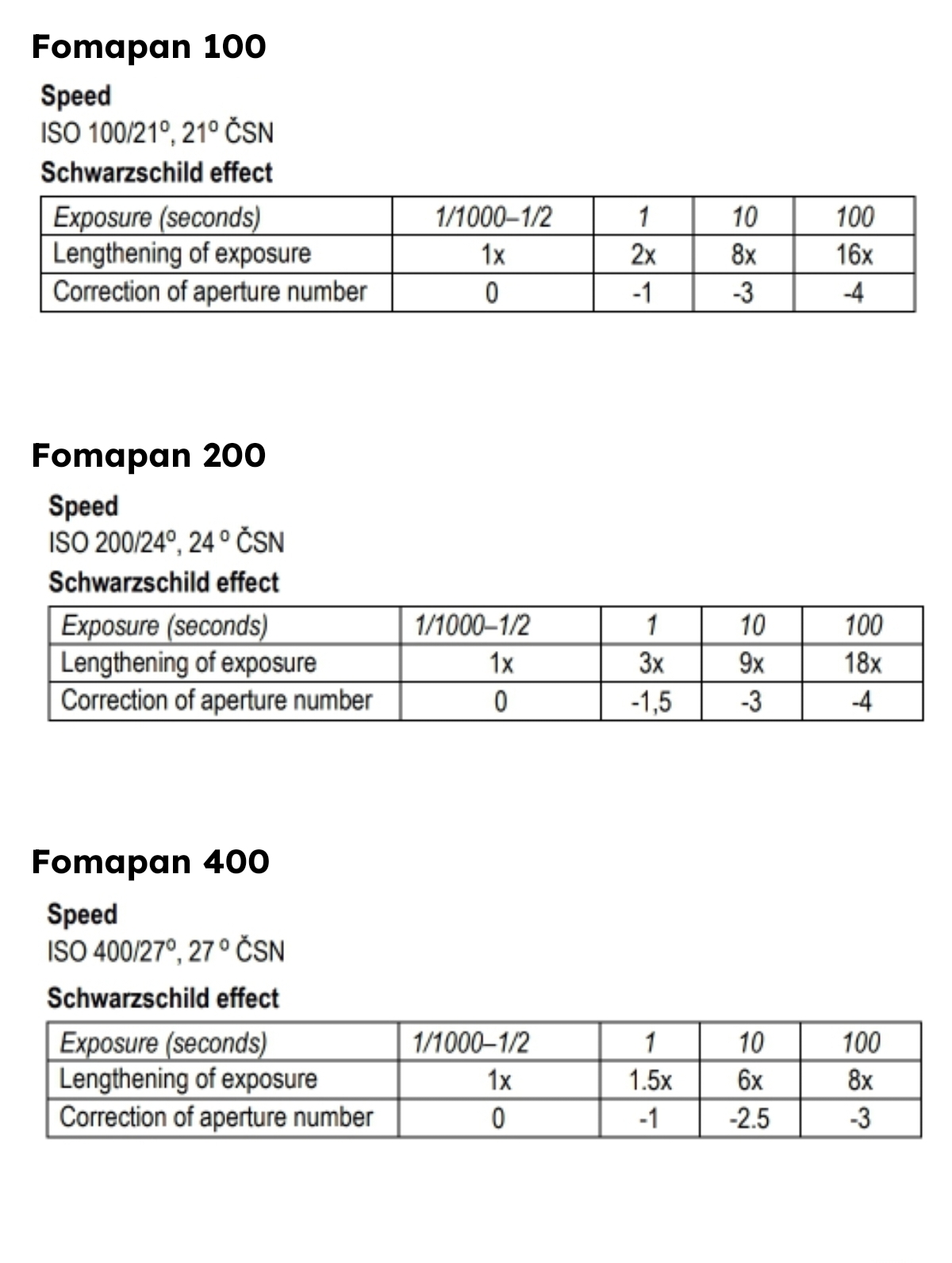

Haven't done much long exposure with the 100 film. But Fomapan 200 works very well with Fomas times, at least up to 60min exposures (calculated).
These times look similar to what the OP has been using, so they probably won't help him much.
