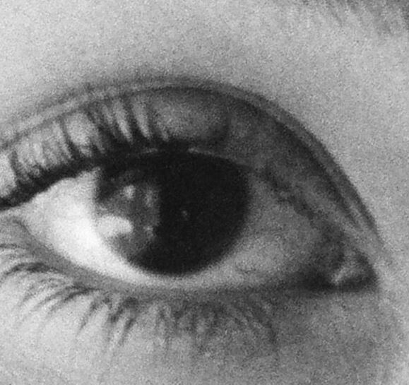

The grain of fresh Fomapan 100 I would compare to fresh Kodak Double-X 200. Makes itself felt pleasantly while being able to render detail well up to 4800dpi (something that Fomapan 400 can't quite do). There is the occasional emulsion defect (tiny black spot) but not enough to bother me.
I actually prefer Fomapan 100 a little underexposed, setting it at 125 or 160. It's an odd duck that it handles modest underexposure better than overexposure.
Here is an approximately 3mm x 3mm crop, about 300 of these would make up a full 35mm frame. The full frame is a standard head shot.
