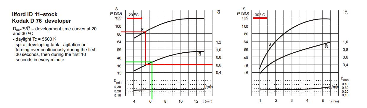

Assuming that you are going to use Kodak d76, here there is the graph:
As you can see, to reach 25 iso you have to develop for about 1minute or less, to mantain a lambda of 0,6.
Around 1m30 at 30C...a much more reasonable time at the more common 20C. But like I said: only a modest reduction in development will yield good negatives. I used mostly pyrocat and later mytol/xtol for this.

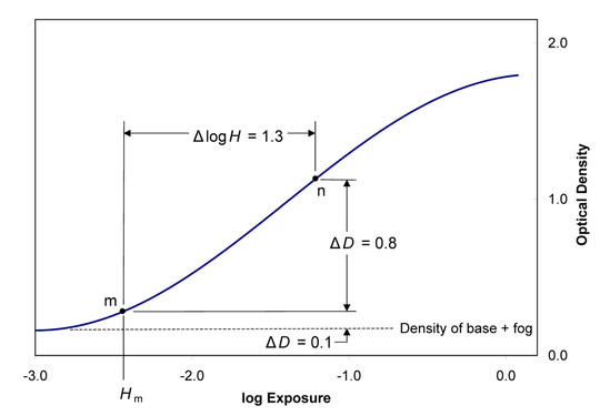

ISO speed imposes fixed a 0.8/1.3 = 0.62 gradient, not another one !!!! It has to be 0.62, other gradients are not valid for ISO Speed.
"m" is the ISO (initial) "speed point", "n" is x20 more exposure than the speed point. Meters aim x10 more light exposure than in the m speed point, so 3.33 stops more light.

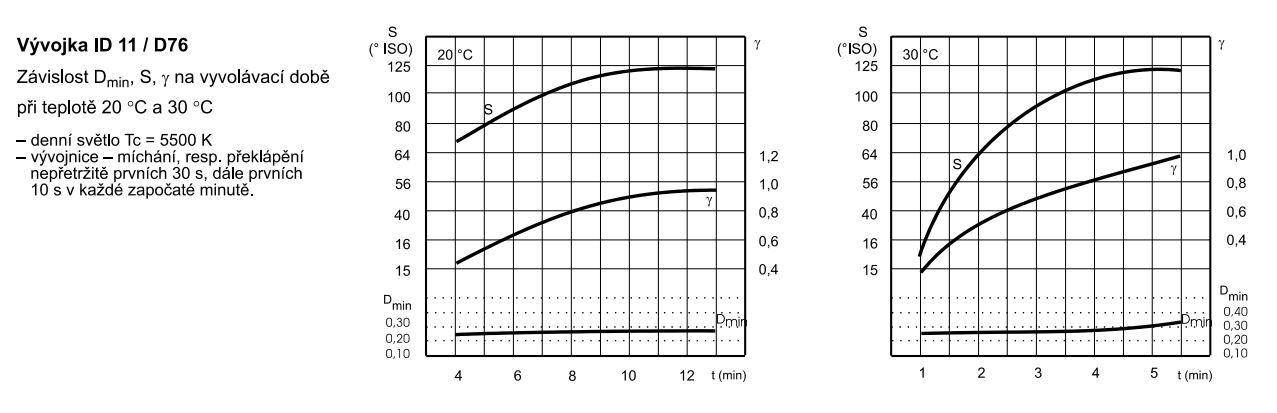

Obviously the y axis on the Foma graphs refers to the speed you have to set on the camera, and not to the real film speed.
Yes, you are right... we can consider "S" it is the EI, in the English datasheet it is better understood by me (https://www.digitaltruth.com/products/foma_tech/Fomapan_100.pdf) This is technically confusing because those those speeds are not ISO...
The weird "1min" is for 30ºC development.... ID11 and D76 share the same graphs, it is not the left for one developer and the right one for the other, each graph is for both, if we use the left one that is for 20ºC... (the right one is for 30ºC)
Then with D-76 we obtain around ISO 80 for a ISO Standard (gradient) development. (Showed in red) if trusting the graph.
They also say you have to develop around 6:15 min for "ISO" EI 25º (showed in green)
