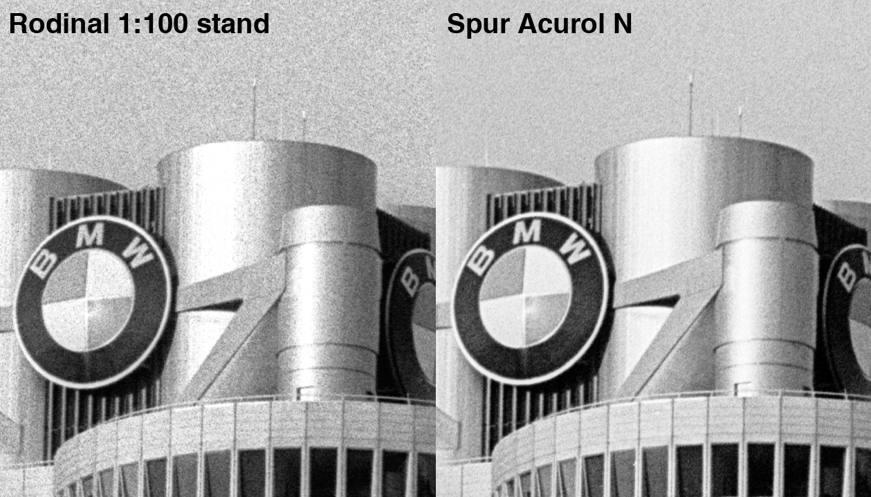

Here is a direct comparison between Fomapan 100 in Rodinal 1:100, stand, 60 minutes and Spur Acurol N. The negatives were scanned with 4000DPI on a Nikon Coolscan 4000. Each crop is about 4mm wide on the negative.
Disclaimer: I know that it is not absolutely correct to compare grain only based on negative scans, but my experience with scans from the Coolscan 4000 is that you usually see what you get. The grain appearance and structure on the scans is mostly very similar to how the grain appears on a traditional wet print.

I have today developed Foma 400 in Acurol N and Foma 100 in ID11 so that I can compare both Foma 100 and Foma 400 developed in Acurol N, Rodinal (1:100 stand), ID11 (stock) and Rollei Supergrain with several other films.
With Foma 100, there are obvious differences between the developers
  • In Acurol N, as mentioned earlier, the film is actually quite good. Grain is fine, the negatives are sharp and tonal values very nice.
  • In ID11, grain is perhaps not quite as fine as in Acurol N, but still acceptable, but there is a clear lack of sharpness. The antennas on the roof (see my previous image) can almost not be made out.
  • In Rodinal and Rollei Supergrain, the grain is very coarse for a 100 speed film. In Rodinal, it actually looks very similar to Tri-X or HP5+.
With Foma 400, there is not much difference between the developers. With all developers, the grain is very coarse. If I had to order the developers by coarseness, I would say that Acurol N gives the coarsest grain and Rodinal (stand) the finest. With these developers, the Foma 400 grain is distinctly coarser than Kodak Tri-X, Ilford HP5+ or Rollei RPX400.
So except for the combination of Foma 100 and Acurol N, my prejudices against the Foma films have mostly been confirmed. I still have a few other developers I was planning to test with. Perhaps I'll find another gem by chance.
