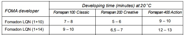

It is very confusing as the bottle label states dilution of 1+10 & 1+14 but gives the times for just 1+10. I did a little research and found the times for both 1+10 & 1+14

FYI: according to this website, the 1+14 dilution should only be used for 100 ASA film.

Yes, I thought that too but when you do that you don't get the same time as in the chart.
EG, the chart says Fomapan 100 in 1+10 is 7-8 mins.
The chart says Fomadon 100 in 1+14 is 9-10 mins
7 mins x 1.4 = 9 min 48 sec. 8 mins x 1.4 = 11 mins 12 sec
It is all very confusing.
