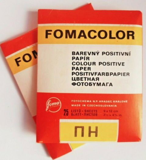

Can I process this paper in RA-4 chemicals? For photograms...
That's very kind of you to suggest that, thank you, but my question was can It be processed in RA-4 chemicals?
I am not ashamed to say I do not know, or rather I am not sure.
But I think that maybe it can work, and maybe there is another process for that category of paper.
I'm really not sure, because I'm not a print specialist and I've never been to print before. I only develop films.
I am quite sure this paper is based on the Agfacolor couplers.
Well, paper is now over 40 years old, or when did the Czech Republic split with Slovakia? You can contact Foma, they might know.

You can even try to develop this paper in usual b/w chemisty (in full darkness), these kinds of paper had high silver content, more than modern b/w paper.
It is processable in RA-4 at lower temperate (25 or less), but I'm afraid you will get monocolored image of purple or orange fog. Sometimes people find suitable for prints without high colored fog, for example, the internet auction for such paper, third photo:

This is really interesting thank you, I am actually using different colour papers for abstract colour photograms, such as the one attached. I tried this paper in RA-4 chemicals and got different colours....which is good.
