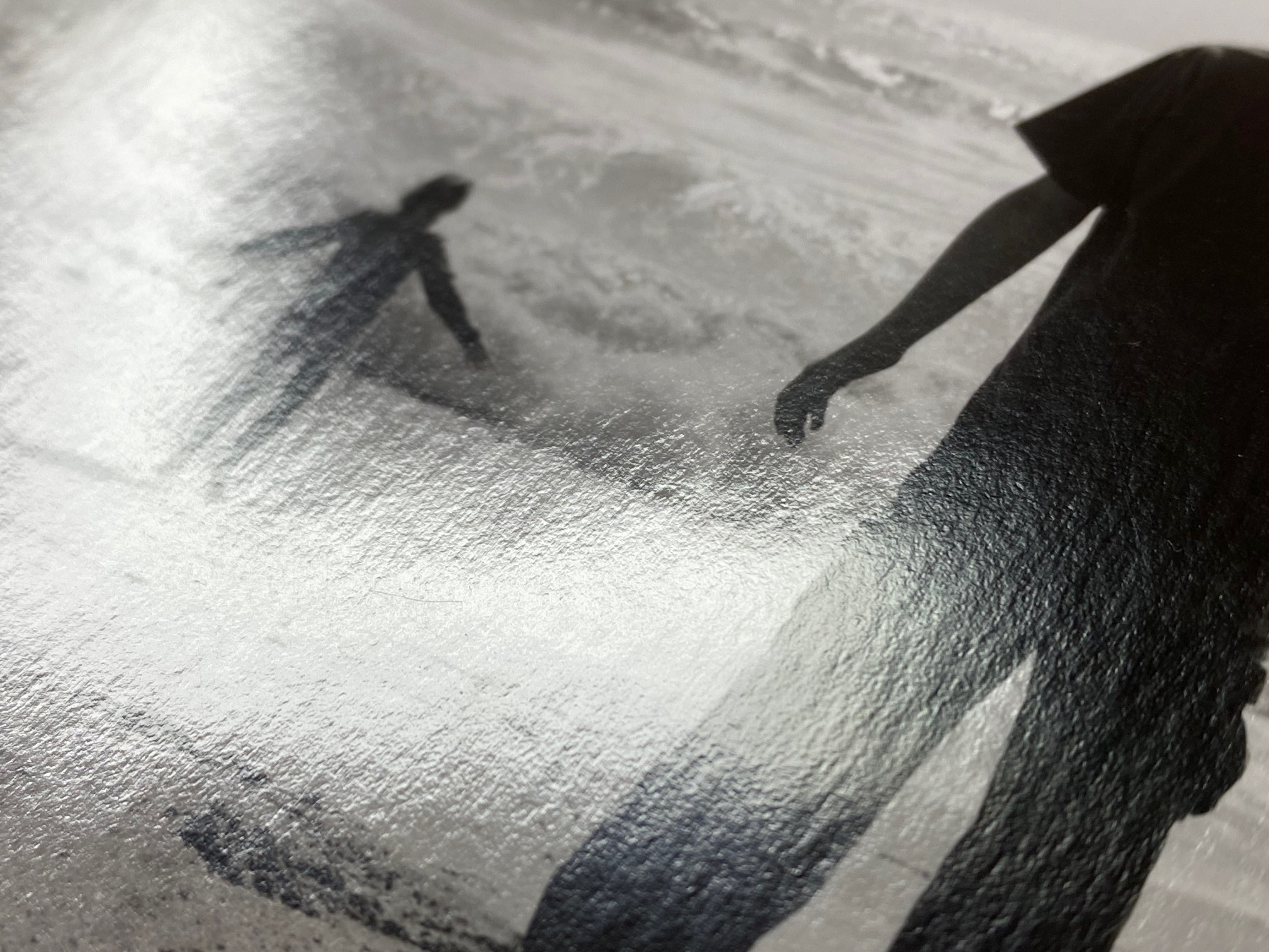

Here goes… the effect is subtle, and may only reinforce the point that it’s negligible. Sorry for the crappy phone pics with messed up white balance.
“Etching” or relief visible with reflection. White looks more glossy than black:

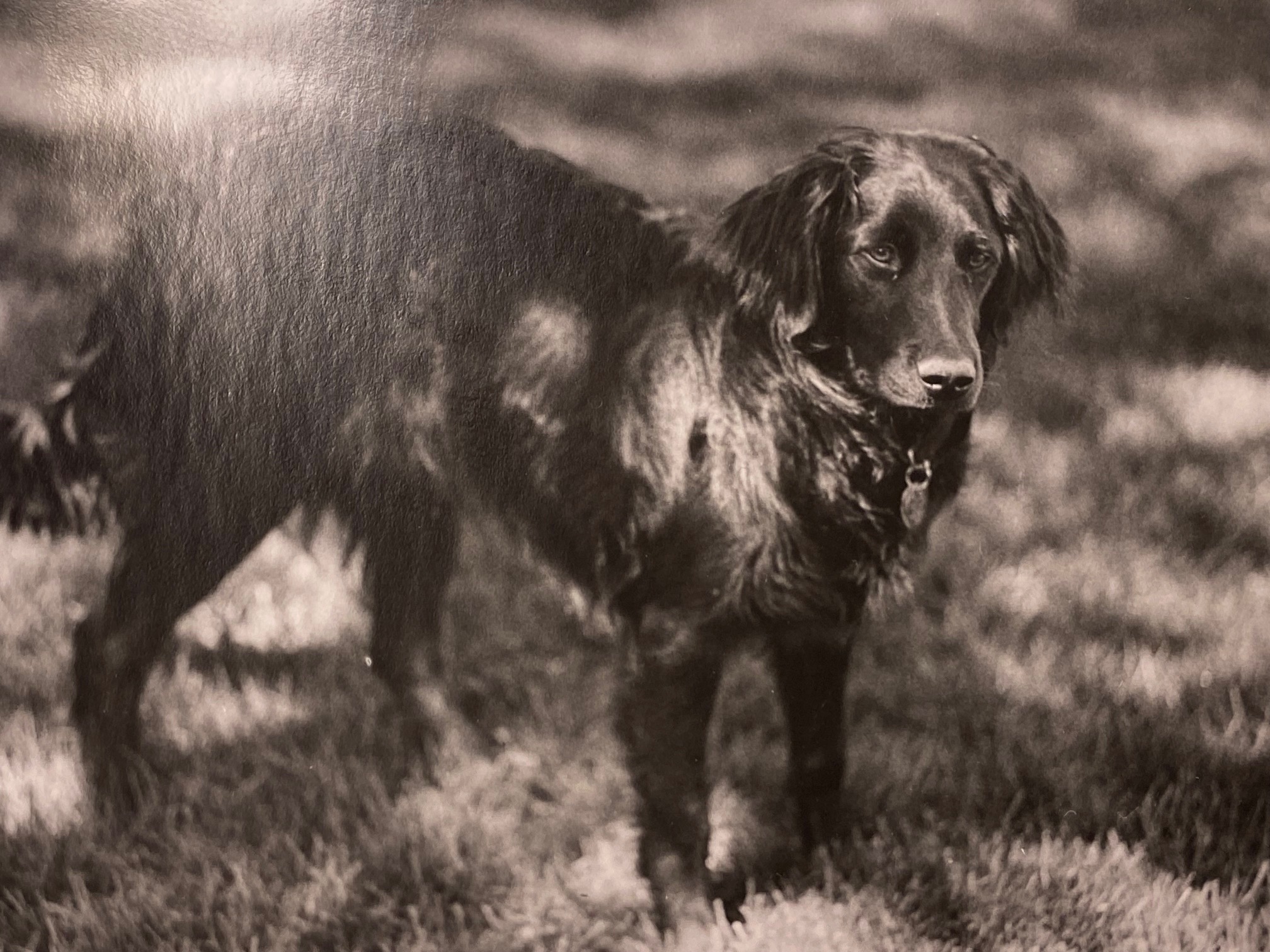

Normal viewing angle looks more natural:

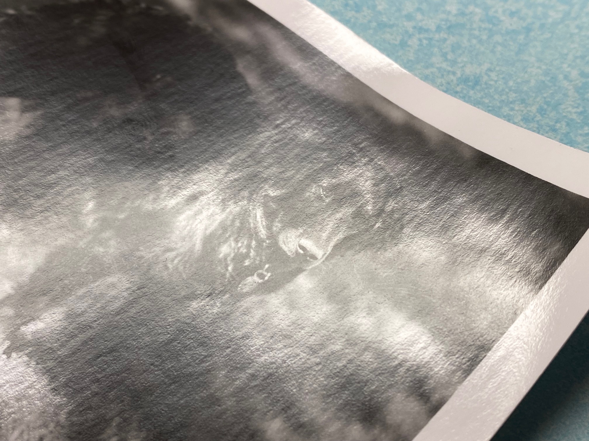

For the record, previous boxes had more uniform and possibly higher level of gloss. This from several years back:
Well, I can't really see what you're describing. I wonder if it's maybe just normal scatter from the thinner areas of the print that create the suggestion of a variation in the surface quality. IDK. What I see is the normal surface of Foma papers. Ilford has a more regular surface quality that some may prefer (the question is how much one is prepared to pay for that very subtle difference).
