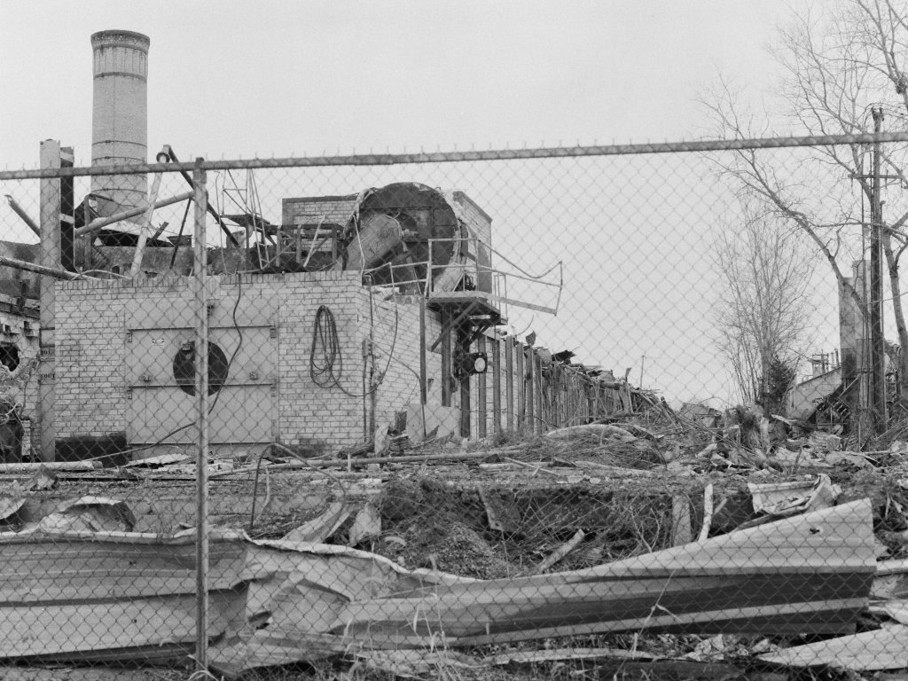

That's what it is basically. I will give it another go on a day that isn't overcast for several counties across

Here is a sample.
