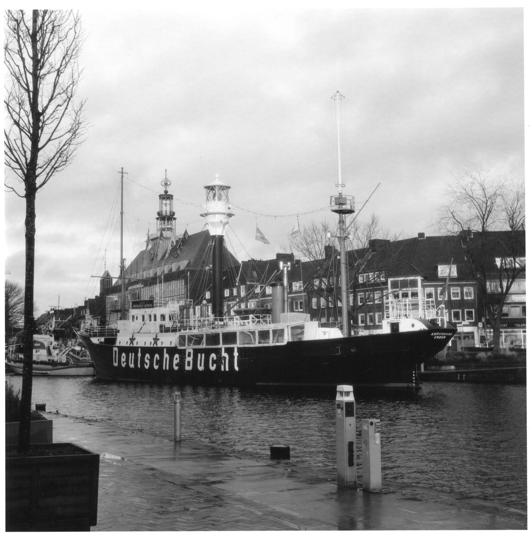

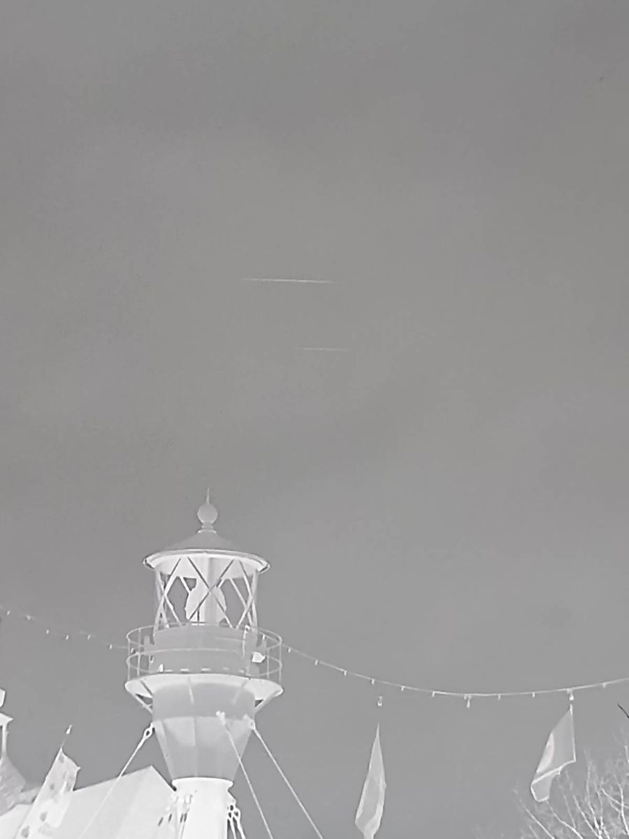

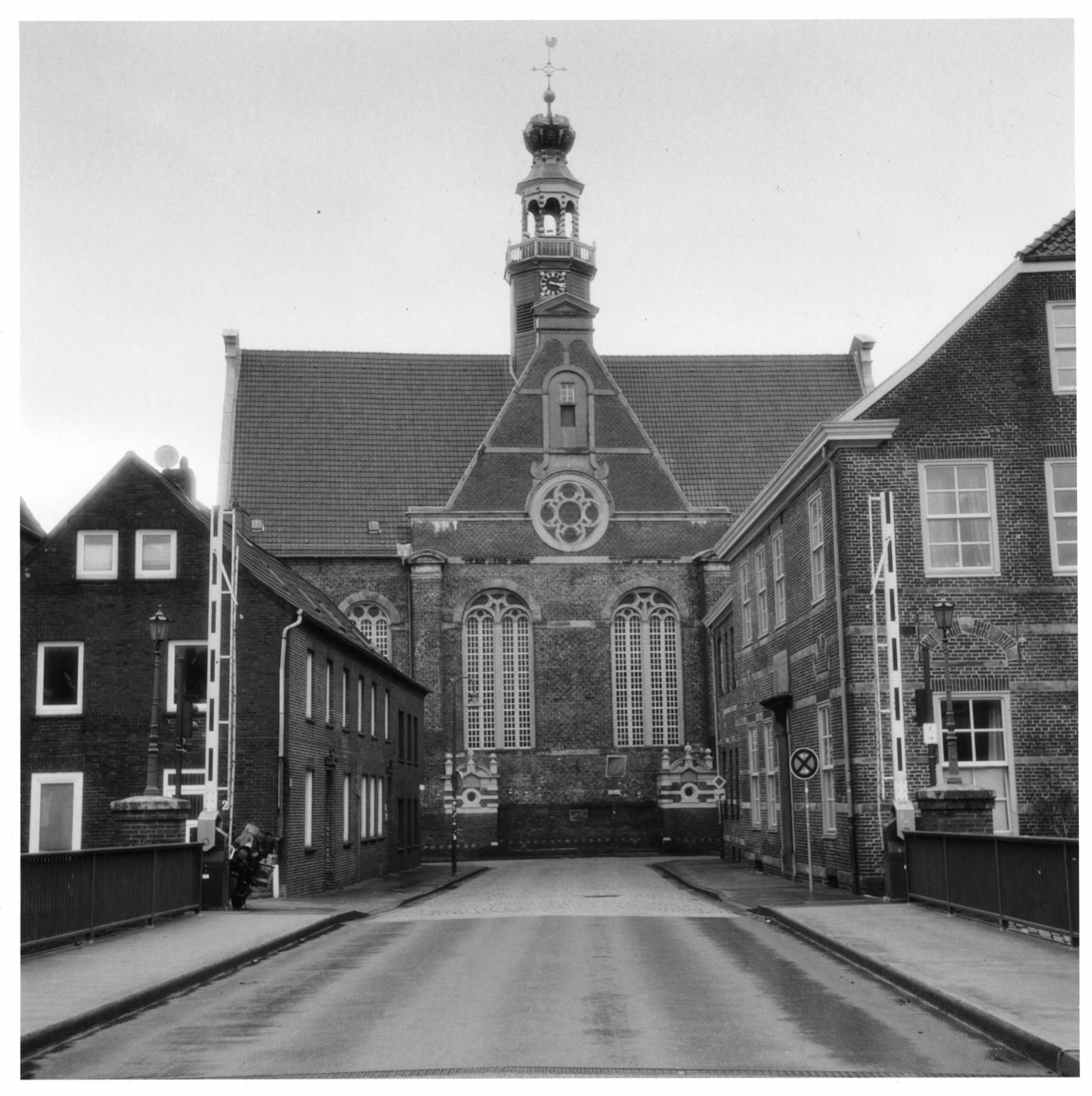

Some sample images, taken on a cloudy winter day. Still quite contrasty negatives. I developed in Adox XT-3 (Xtol) 1+2 12 Min, and another roll 1+3, 15 Min.. Both with nearly perfect results. The grain is fine, the sharpness good.
With Foma Ortho in 120, I had some issues with scratches. They came from factory, not from my handling.
