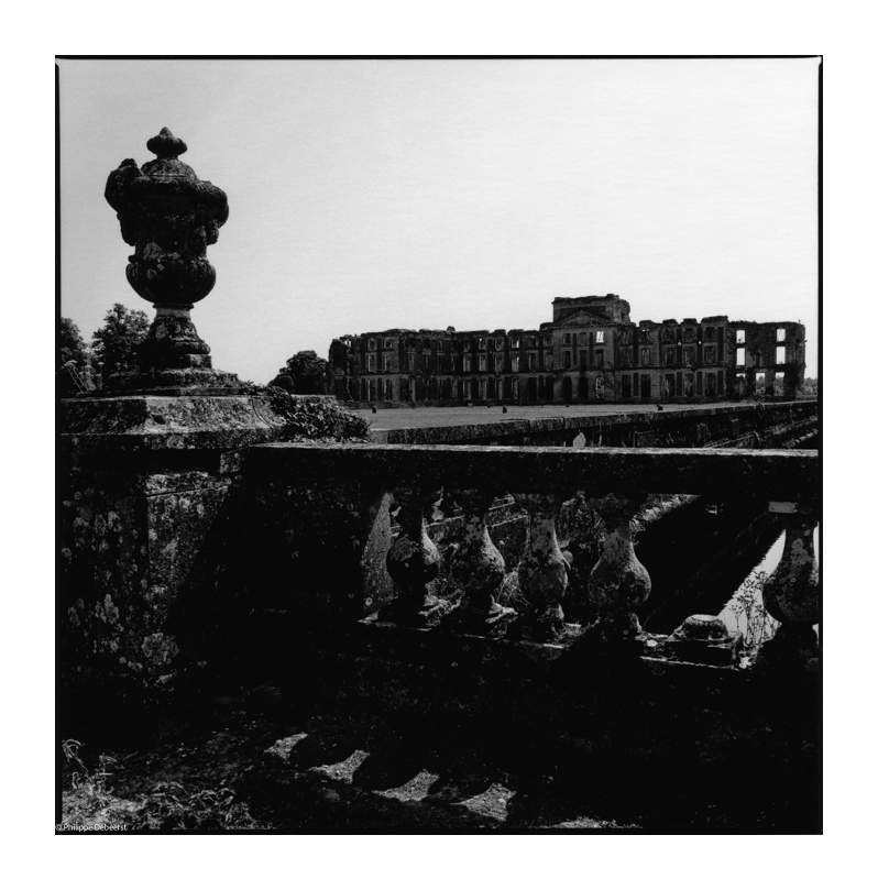

I never got these reddish brown tones on Fomabrom FB 111, but that's not my goal, I want to enhance the blacks a little and the preservation of the print too, but, as I said, I don't get the blacks enhancing anymore, even wit freshly mixed KRST, strange...
Perhaps there aren't any blacks to enhance?
What you see here is one of these prints on Fomabrom FB 111 wish didn't wanted to react on KRST, this was directly scanned without any postprocessing in PS.
But, yes, it's a total contre-jour...
Château de la Ferté-Vidaime, départemen Eure-et-Loir, France.
