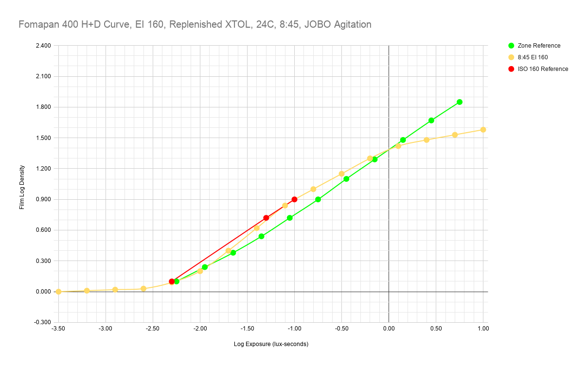

For reference, and if anybody wants to discuss.
I've made these exposures as carefully as I could and eliminated as many variables as I realistically could. While it is not scientific, and certainly not up to ISO or probably manufacturer standards, it is as accurate as I can make it with what I have available to me, and certainly accurate enough that I thought it would be share-worthy.
Each of the curves is from film base plus fog up to a correctly exposed 18 percent grey card in full stop increments using a studio strobe, and transmission rated lens set to infinity focus. The strobe was incident metered to 1/10 stop and varies less than +- 0.1 stops shot to shot. The intensity of the light to the film plane was controlled with the lens aperture, so once the strobe power was set, it did not change for the duration of the exposures. The 18 percent grey card filled the frame so there shouldn't be any flare.
The densities were measured with an X-Rite Densitometer.
Fomapan 400 H+D Curve, EI 160, Replenished XTOL, 24C, 8_45, JOBO Agitation.png
In replenished XTOL in a JOBO at 24C with continuous agitation, I couldn't get better than ISO 160. The flash I was using has a t.1 duration of 1/900 at full power and 1/300 at minimum power so I was within the reciprocity failure of the emulsion.
Pushing to 10:00 at EI 160 has almost no change on the bottom end and only gains ~0.1 more density at the top, but still totally shoulders off. The exposed tongue of the film never exceeded 1.72 above film base plus fog at 10:00 development time.
Other than that, I'm not particularly wild about the shape of the curve, but it's roughly representative of what Foma has published in their tech sheets, at least in terms of shape, though they seem to be able to get a lot more density.

@Adrian Bacon - I recall from the available published data, Foma suggests that Xtol runs out of steam in about the Gamma 0.75 range (at a claimed EI of about 225 I think) unlike Microphen or D-76/ ID-11 which seem to be able to develop more contrast. It's an OK film in actual use, though it isn't as sharp and the halation seems worse than more modern films.
FWIW, my results with Foma 100 and 400 in Xtol 1+1 using MDC times were not great (too thin). Instead of tinkering with it, I've placed Foma into my "D76 bucket of films". It's a quirky film but its quirks are great with D76.
We need "Adrian Bacon D76 Edition" here to do the god's work of testing films with D76 :smile: For those of us who haven't converted into replenished xtol religion for various reasons.
@Bormental - I've found that the MDC's relationship to the manufacturers' data to be at best extremely questionable.
Sorry, I am not following. Foma 400 datasheet does not list times for Xtol 1+1, only for full-strength, so MDC was the only starting point available. Is there another PDF published by them that has more? I'm interested because I generally like Foma picture and want to keep improving at shooting it.
What is important is the shouldering by +4 overexposure, telling how this film has to be used, having to underdevelop if wanting linearity in those extreme highlights. I feel that shouldering can be interesting if accurately metering, to compress highlights to be printable.

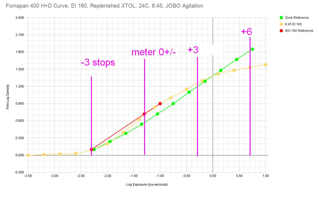

I think it's interesting to also see the meter point position when rated EI 160 which is the right one, of course:

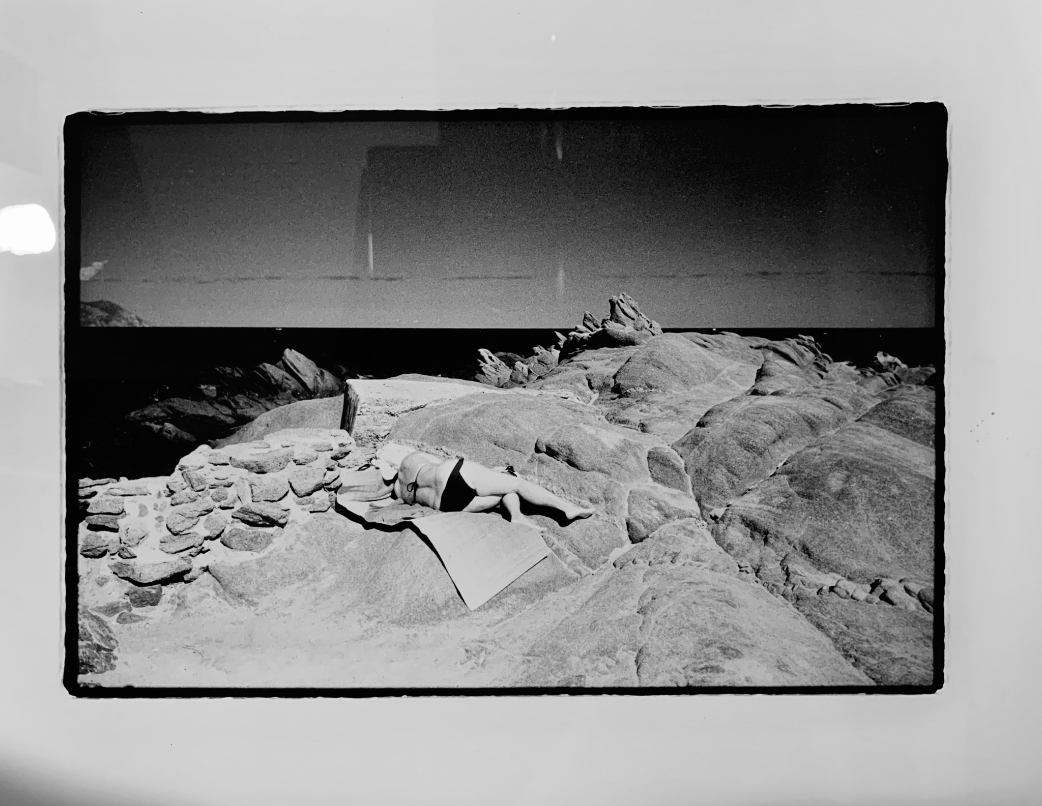

yep, it does noticeably shoulder off. Looking at the actual negative, the top 2-3 stops are totally bleeding light into adjacent frames, so up there you’re completely overwhelming the halation layer.

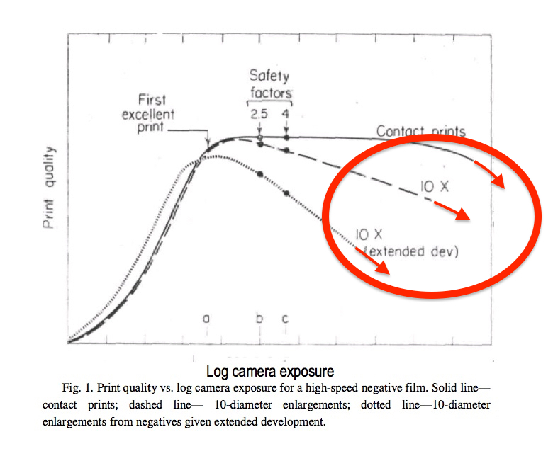

A few generic comments on analyzing the shoulder of films.
1) The way a sensitometer works, the shoulder is exposed through the clear or nearly clear portions of the step wedge. In many cases, the light intensity is not enough to get to the shoulder without multiple exposures.
2) The toe of the curve is produced from the dense portion of the step wedge. Even with expensive carbon step wedges (vs photographic film based step wedges) they are limited in the maximum density to fit the whole series in the sensitometer's target area and yet still have steps large enough to be read by conventional densitometers. Usually 21 steps that are 1/2 stop apart (0.15 log d).
3) Put 1 and 2 together and one should see why a common H&D curve only shows the toe and cuts of the shoulder of most films.
Finally: A comment about my own experiences with placing portions of the scene on the shoulder. Although it seems like it might be a good idea to tame highlights, the prints look bad. I'll describe it as an analogy with an under-exposed negative.
As the curve becomes more horizontal, the separation between the zones becomes less, which is the opposite of what one wants.
An example: If one has three negatives; a) correct exposure for excellent print, b) severe under exposure and c) severe over exposure with portions of the image on the shoulder.
Print all three negatives so the darkest shadow is just black on the print, and the brightest highlight is just white on the print.
How do they look? The correctly exposed negative makes a perfect print with mid good mid tones (by definition). The under exposed negative makes a print where the mid tones are too dark. The over exposed negative (the one with portions on the shoulder) makes a print where the mid tones are too bright. It is an odd look and frequently not pleasing. I'd encourage people to try this to see what it looks like. Maybe it would be used in some special case.
What ?
Look, all the zone system literature is based in taking advantage from toe and in the shoulder to compress shadows and highlights when necessary.
No mistery, a paper only displays 6 stops and a half. Mids require an standard gradient on paper to not look dull, and the excess dynamic range the scene has can only be compressed to robe some range in the 6.5 stops the paper has.
The problem happens when unsing a linear film like TMax, highlights are to skyrocket to unprintable values if special print manipulation is not used.
Zone System basicly teaches how to place scene spots in uncompressed or in compressed zones, this what Adam's The Negative and The Print explain. All that pool of amazing classic work is based in exploiting toe and shoulder proficiently.
Yes... the John Sexton way is making a TMax linear capture to obtain a flexible negative and later manipulating what necessary to place the scene DR on the limited paper DR, at the end a wide DR scene needs compression to fit in the paper inferior DR, you do that more in the metering+processing or you do it more in the printing, those are different approaches, but no way is better or worse.
The toe and shoulder are horrible placed to place important image information if one wants a good looking print. Of course if one is doing 'something special' or unusual, anything goes.
Compressing on the shoulder makes bad looking prints. You may be misunderstanding something you have read. That is ok, I teach for a living and can post some links to useful information about film's response to exposure and development.
