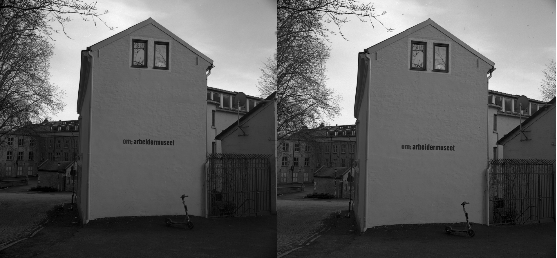

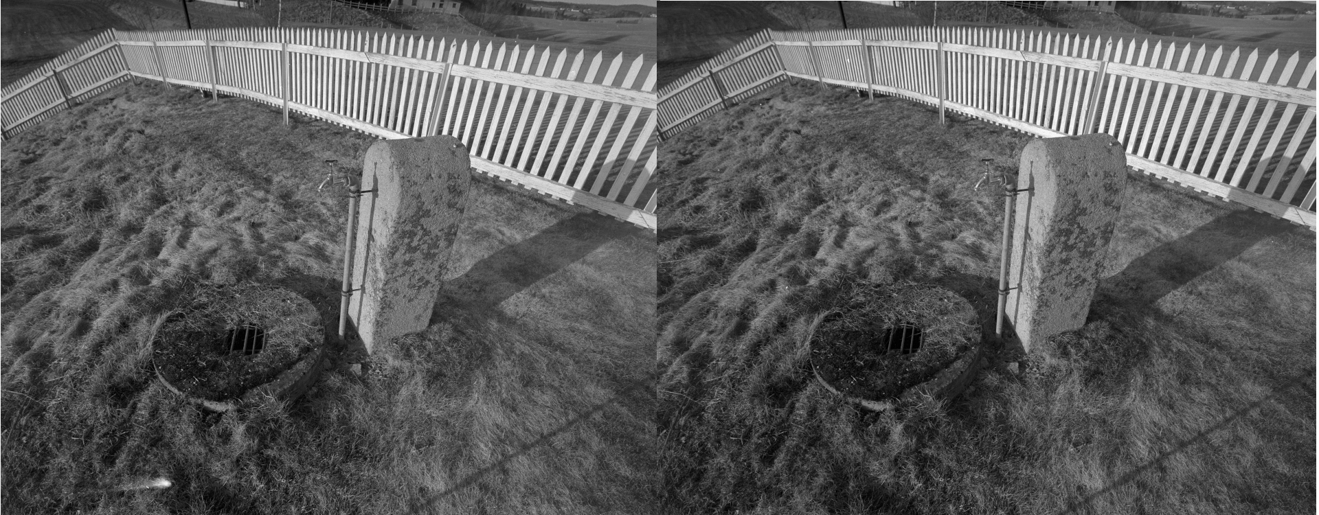

I wanted to see if Tanol makes a difference on Foma films. Wolfgang Mörsch provides no data for these films, so I extrapolated some possible times, and tried Fomapan-100 with 16 mn @20C, regular agitation (30s then 2 inversions every minute) and it gave results similars to Fomadon Excel.

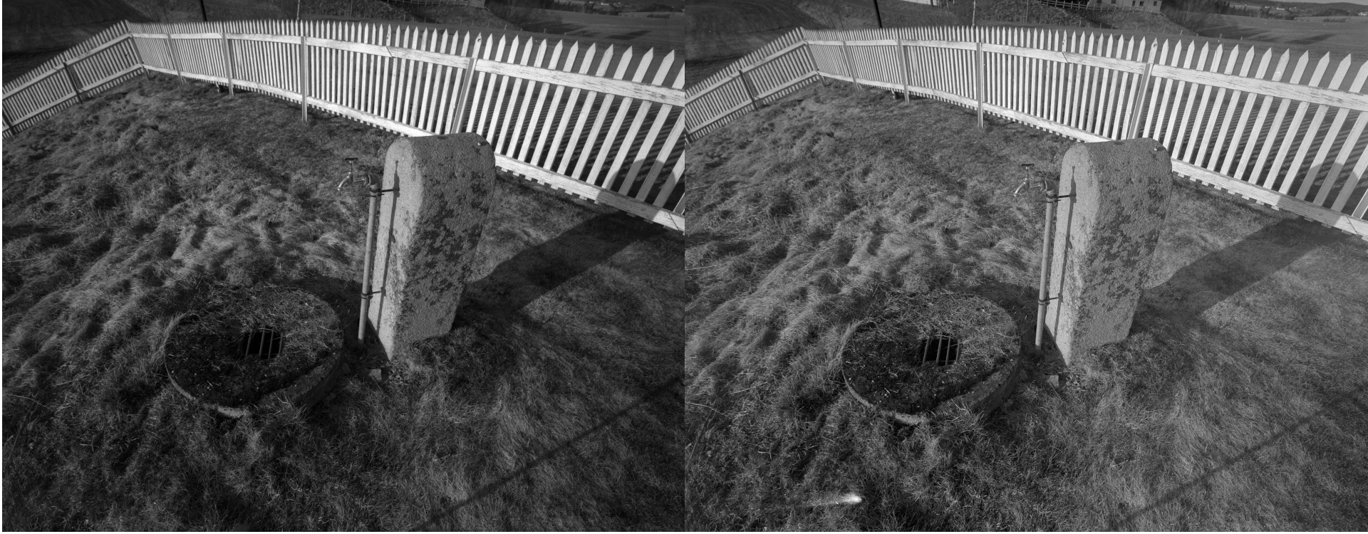

But in order to compare I am now shooting in double, one negative processed in Excel for 6mn, the other in Tanol 16mn. These are 4x5, scanned at 2400dpi on Epson V700, inverted with ColorPerfect, Fomadon Excel on the left, Tanol on the right:
comparison is of course also complicated by the fact that optimal time in Excel is not easy to set, 5 or 6 mn...

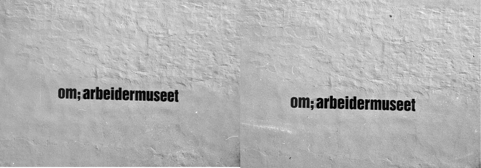

a 200% Excel/Tanol detail of the 1st image:
a 50% part of the 2nd image:

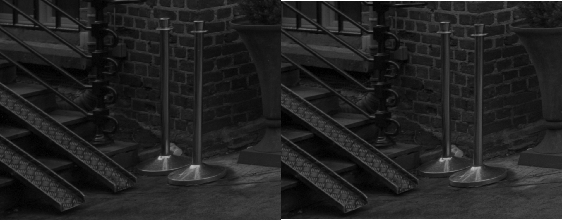

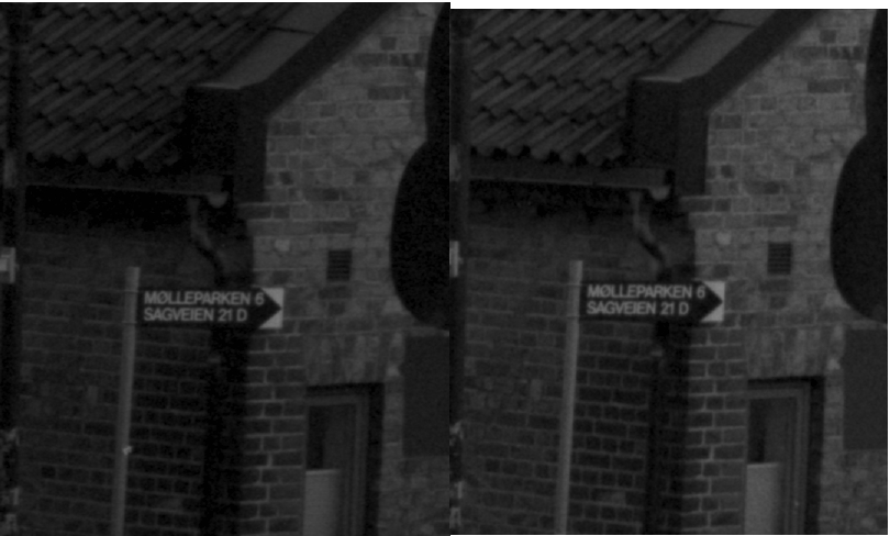

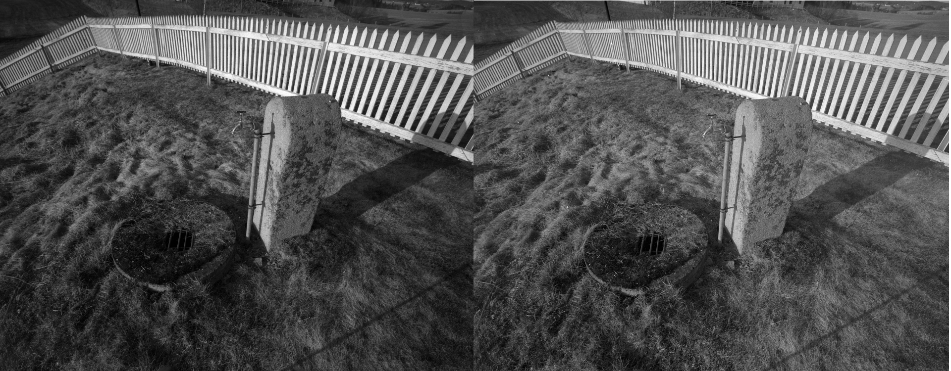

then for Retropan-320 I shot in triple, one picture for reference in Retrodev, another in Tanol 15mn, another in Tanol for 18mn, need to bracket in order to find out, yet 15mn or 18mn didn't make much difference...
Retrodev vs Tanol 15mn:
Retrodev and Tanol for 18mn. Retrodev was freshly mixed and times given by Foma are 4-5 mn, I went to 5mn and maybe it was a little bit longer than optimal... Very sunny late evening, snow smelted couple days ago so the grass there is brownish/yellowish.
in fact I am not sure which one was 15mn in Tanol, which 18mn: I developed both in the same tank, took out in the dark one after 15mn and dumped it in a stop bath, while the remaining in the tank was left until 18mn. After the stop bath I dumped the negatives each in a different tray for fixing, and that's when I am not sure I mixed the labels taped on the side of the trays...
so side by side, one was 15mn in Tanol, the other 18mn and I'd say the 18mn is on the right...

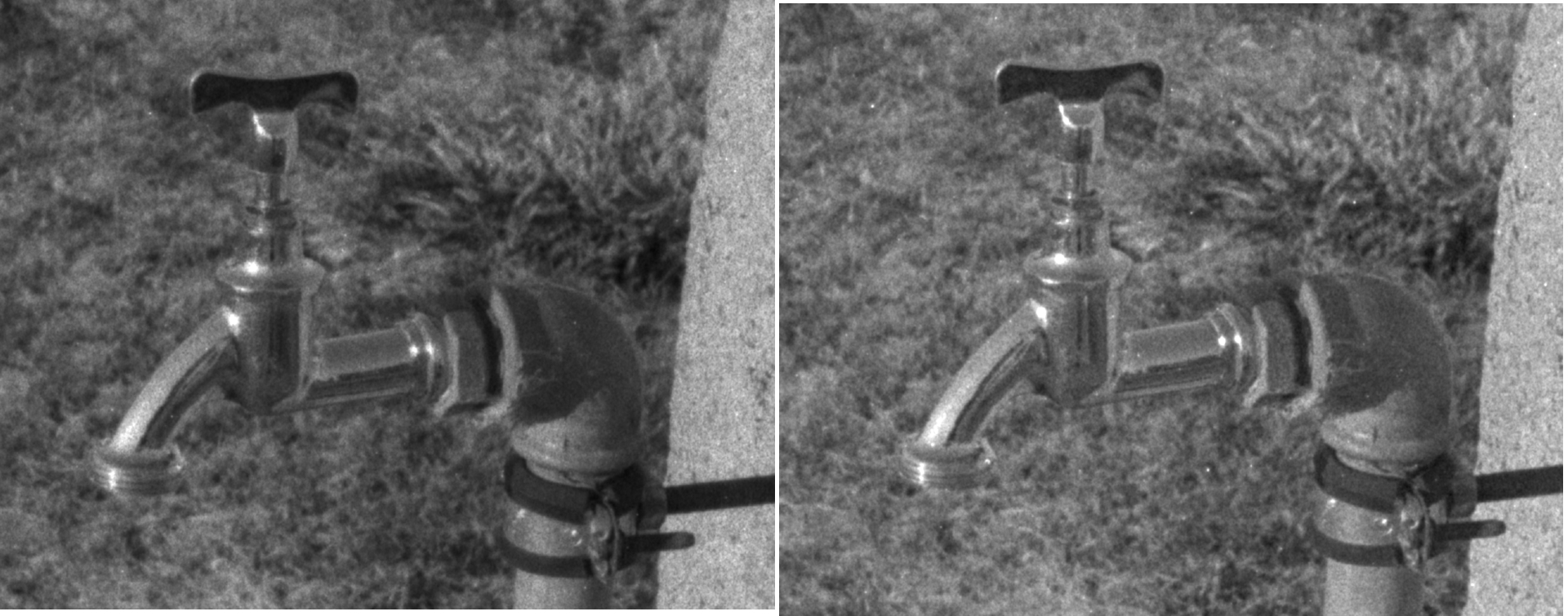

100% of the crane area, Excel vs Tanol-18mn:

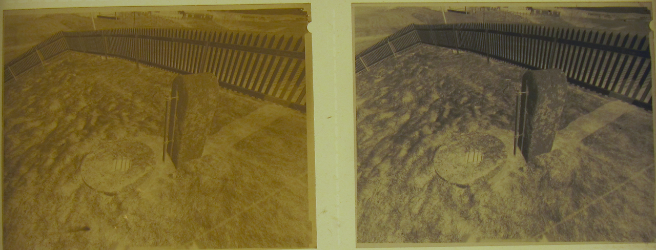

Fomapan-100 and Retropan-320 are stained brownish, Tanol on the left:
well hard to tell how much, if possible can be gained in this case, with Tanol, but at least I have some reference for playing further. Foma in 4x5 is cheap, so can afford to waste some film.

What I'm noticing here, to my eye, is that Tanol contrast is lower and shadow detail is a little better, so achieving a slight speed bump?
Me too and in all cases I prefer to Tanol shot but am I seeing what is accounted for by the difference in the two negatives and even if I am is it the kind of difference that could be corrected by an alteration in print grade or by alteration in development time?

It does look really nice. Not massively nicer than the Excel, but definitely noticeable.

Possibly, but there seems to be a little tiny bit better gradation to my eye.
yes i see too a bit better shadow details on the Tanol ones. But also the Foma devs ones were a bit overdeveloped I think, Foma gives times with 1' variation, and 5' or 6' with fresh developer, depending the exposure used, can make quite a difference. In fact when I opened the negative in ColorPerfect for inversion, I had to pick an emulation of 00 grade paper in order to have a usable positive without post-processing, and I did use the same grade emulation for the Tanol negative, for comparison (CP has a setting providing full grades emulation by half-steps).

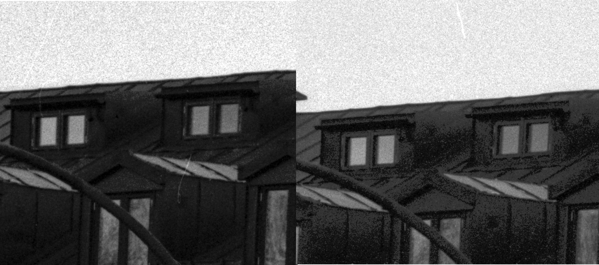

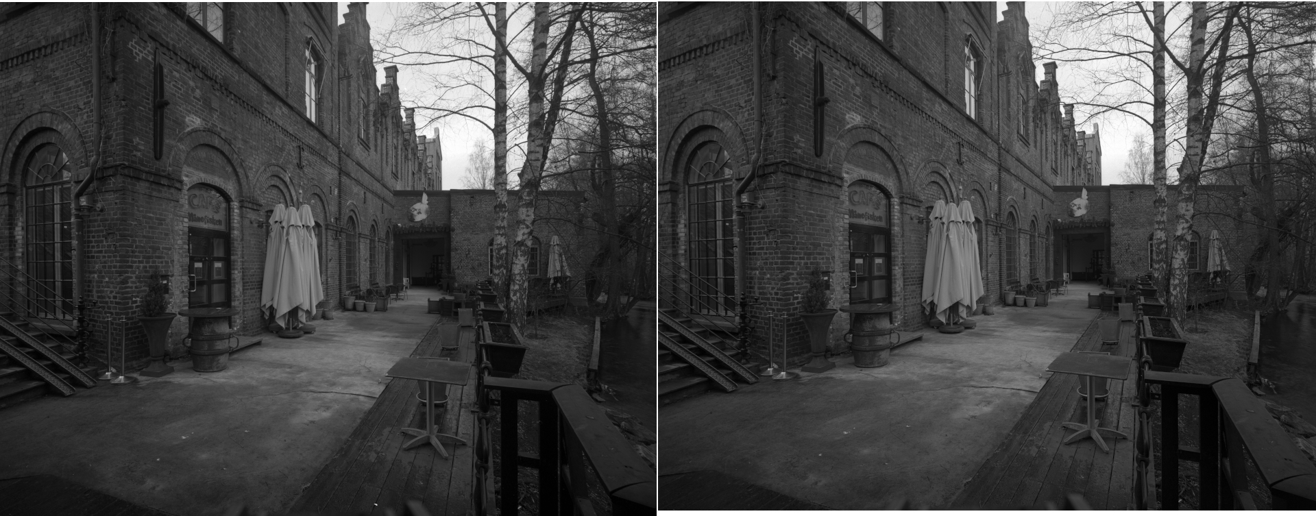

ok, so in other to inspect this closer, I have a Reflecta Proscan 10T I use for 35mm scans. It's marketed 10.000dpi but it's double extrapolation of its actual resolution which is measured by ScanDig GmbH/Patrick Wagner as ~4100 if I recall well with a Dmax in the ~4.
I took the first shot on this post, the whitish gable wall with an uneven cement coating and "om; arbeidermuseet" on it, backgroung some brick buildings, I cut a strip 35mm wide on each 4x5 negative and scan that in the Proscan set at 5000 dpi multiexposures multipasses.
Excel left, Tanol right. For these in ColorPerfect I used the default emulated paper grade 2:
here i had to use the lowest paper grade 00. I think I metered on the wall, because I recall I was interested how the structure ot the coating could render, but for this test I had better metered for the darker brick buildings background...

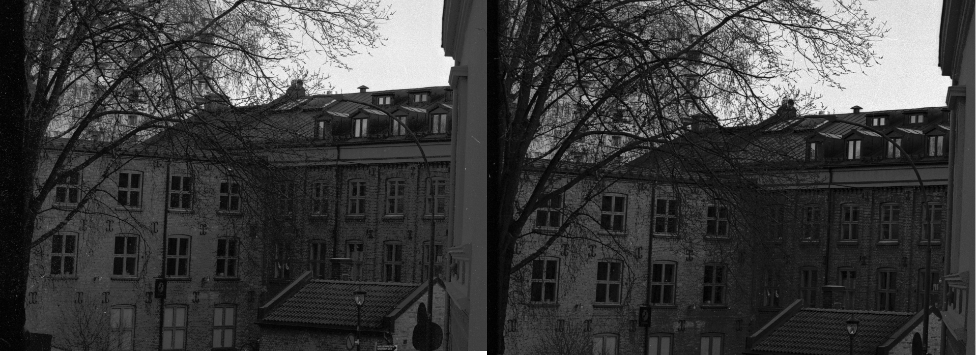

100% of of chunk of the roof, Excel on the left, Tanol on the right, there we see grain difference and more ...

these more detailed scans are for Fomapan-100. I remind that the developing time of 16mn is something I "found" with some rough comparisons and extrapolations, W. Mörsch doesn't list Foma in his instructions.
I will scan closer the Retropan-320, but well just out of curiosity, its unusual tonal distribution together with its grainier structure is part of its personality.
Yes, I think that shows a much clearer picture indeed. Your example also shows IMO that you have to get down to the dirty details in order to really see differences between developers with regards to image structure.
