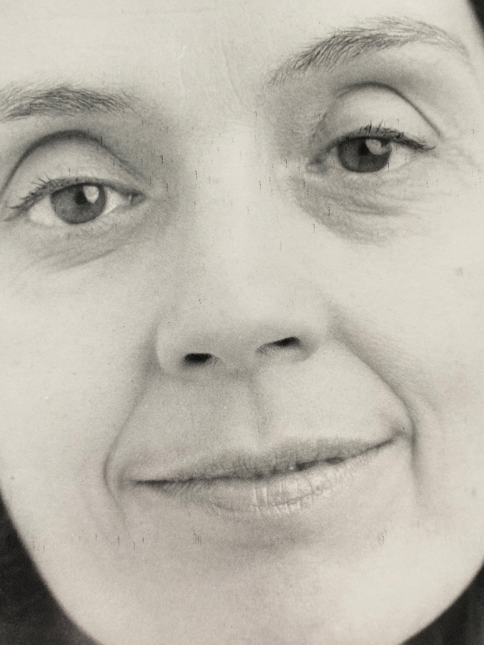

That’s the problem. I really like the look of the film. Grain!! If Kentmere made a 120 film I would try that, but alas.
I looked my old scans (phthyi!) of Kentmere 400 and sure that is grainy. More grainier than Foma 200 for sure!
Those are the most amazing scratches ever. If you look really closely at the actual shape and size of the scratches they are all the same; replicas of each other. It's hard to imagine a camera defect or operator error that could achieve this.
It looks like a problem in the confectioning and packaging of this film.
I've seen nearly identical marking on rolls of Ilford FP3 that had been through a Rolleiflex in the early 1960s - which makes me suspect hardening (or insufficiency thereof) as well as packaging/ handling.
It's not the camera it's the film ...
I’m inclined (along with many others) to agree. Some point to sloppy handling, but I don’t know how to engage that assessment.
I suppose I could wind the film slower on to the Hewes reel, but that is the only change I can envision making. I don’t throw loose change in my tank for audible accompaniment whilst agitating; I don’t squeegee; I don’t use Stop; and no other film I develop shows scratches like this.
If the emulsion is truly orders of magnitude more fragile than literally any other emulsion on the market — then it’s *still* the film at the end of the day.
I think it is probably a combination of both. This film is very susceptible to pressure marks and scratches, but in my experiences marks like that aren't already on the film when you get it.
I can conceptually entertain that idea, but am simply not creative enough to fathom what I’d need to do differently so as to *not* get those curiously patterned marks. Changing bag -> Hewes reel -> stainless steel tank -> soak x2 -> developer -> water stop -> fix -> Ilford system wash -> photo flo -> unroll to hanger -> air dry NO SQUEEGEE.
Other than go slower in the changing bag I’m out of ideas. I shoot a pristine condition RB67. As others in this thread have mentioned, I get some rolls that end up pretty scratched, and others less so, and others (few) not at all. If *I* am scratching the film, I’m not doing it with any sort of consistency. Why?
Open to ideas, but skeptical. As I said before, if the emulsion is *that* sensitive, is it worth it?
Worth saying: I actually would love to determine the problem is my workflow — then I could continue to use this film. But what would I change??
I’ll shoot another roll and go slower in the changing bag. That’s the only area I can think of where any kind of friction directly on the film would occur (outside the camera housing) and will report back.
I agree with you. I would suspect the film manufacture. or the developer not being mixed long enough. I'd suggest developing a roll that hasn't seen a camera. Sure do miss Kodak's former line up.

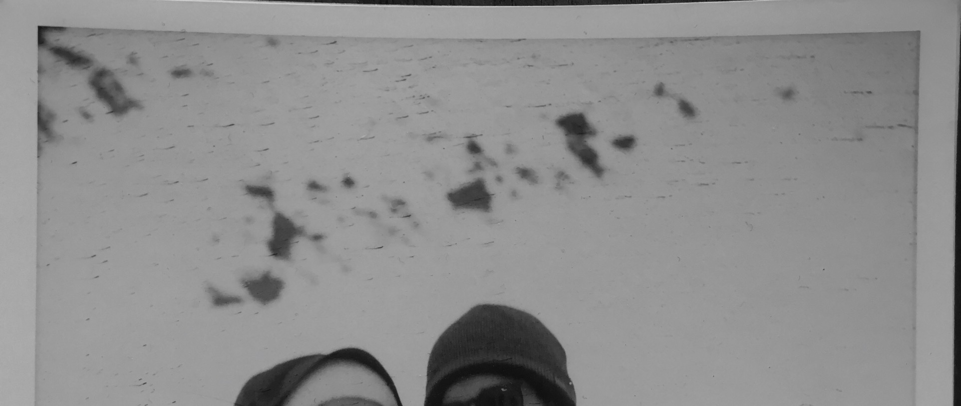

These are my freshest "scratches" on Foma 200 to date. Shown is a photo of an enlargement of roughly the top quarter of a 6x4.5 negative. I, too, would be interested to learn what I would need to change in my processing of Foma films to avoid the phenomenon :wink:
So you have tried the film in anther camera now? Or are the problems still from your "beat up Ikonta"?

This is still a picture taken with the beat up Ikonta. The other roll has 2 more exposures until full, so we're only speaking weeks until I will have a negative :wink:
It's quite interesting that there are 10 year old threads here that describe what looks to me to be the same problem. Allegedly Foma were working on the issue. Yet here we are, 10 years later, with the same issue and none the wiser as to how to avoid it with Foma films.
So, maybe these aren't even scratches. Maybe the emulsion bunches together when the film is on the 120 spool and cracks when it's stretched flat. Then, when developed, a little flakes off.
What is the orientation of the winding direction in the camera relative to the picture? I.e., does the camera wind vertically or horizontally? Then, when you spool the film what direction? Just looking for any clues. I have a bit of Foma also (I think fortunately only one roll of Foma 200, and that in 35mm).
On the sample picture, the film is wound horizontally and it is moving right to left. In other words, the thicker end of the defects are towards the loose end of the film.

I am the one with the beat up folder in thread, so you sound like you direct this at me. The issues that OP is having look pretty similar and there is some history to this as well. For instance in this voluminous thread, the issue was had with a range of cameras and kinds of processing: https://www.photrio.com/forum/threa...of-small-scratches-looking-for-culprit.56515/. Or in this thread, where there are two examples: https://www.photrio.com/forum/threads/foma-is-taking-back-defective-200-120-film.89062/#post-1191088.
It's absolutely possible that the film path in the camera can make a big difference with Foma film. It also possible that my Ikonta doesn't pair well with Foma film. What I am saying is that this issue is not confined to that one guy who has a beat up folder. It happens to a number of people with different cameras and processing techniques who are using Foma films. I am not seeing the same incidence of issues for e.g. FP4.
