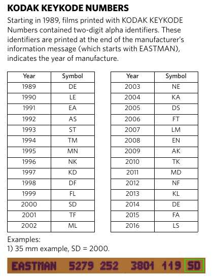

The thing is with XX is you don’t know how old it is unless you buy the can and spool it yourself. And there are superior film such as fresh HP5+ that are not expensive if you bulk.
since they went to Keykode numbering the year of manufacture is part of the edge printing. recentl rolls have the date in the clear, (ie 2021) while you have to use a chart to decode some rolls.
Most of the time, these days, the 4 digit year is now placed where the "SD" code is shown on the example.
In the Keycode system, Double X is also coded as "KE" not to be confused with the date.

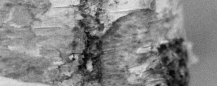

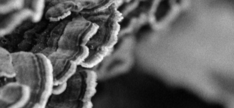

100% crops. First is Double-X @ 200 exposure (from Cinestill), second is Fomapan 100 @ 50 exposure. Both in 510-pyro with normal development for 200 and 100.
With fresh film, the Fomapan seems a little more grainy, and it's exposed 2 stops more. I don't bulk load so I can't help much with those questions.
My other Double-X which was fogged and bulk loaded by someone else has significantly more grain than any fresh 400 speed film I've ever tried. Looks more like what I'd expect from 800 speed.
