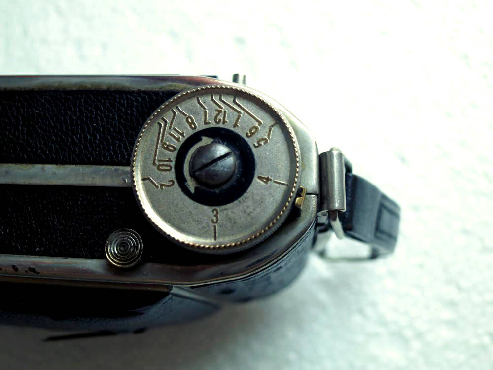

there is a very simple solution for correct spacing on a less known camera, the certo super sport dolly.
having advanced the film via the red window to "1", you lift the advance knob and put the number "1" at the index mark. after each photo you make one full term plus the way to the next number (except 11 and 12, where it's less than a full term, the roll being thicker). on the picture it is on "4". works like a charm. I don't know why other camera makers didn't use the same system.
