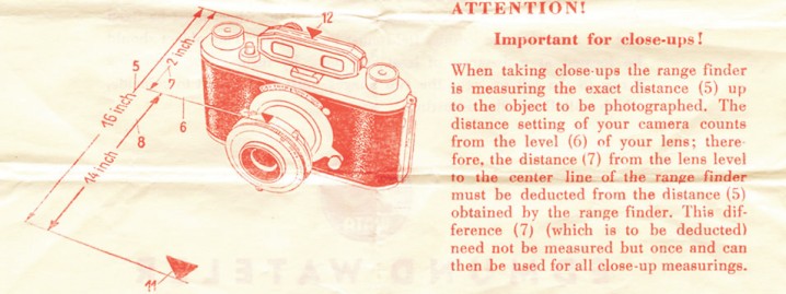

Instructions for the Watameter acessory rangefinder clearly states that when taking closeups, you have to measure to the center of the lens. I would think this was usual practice until interchangeable lenses became the standard on slrs? Then the filmplane became a better priciple?
http://mercurycamera.com/wp-content/uploads/2017/12/watameter-rangefinder-instructions.pdf
-) close-ups with a finder camera (at least within the distance range offered by the Watamater Super accessory rangfinder) were beyond the focusing range of the respective lenses.
Close-up then meant using an additional close-up lens.
As with these the object has to be put in the focal point of the close-up lens and the camera-lens set at infinity, the only distance information one got thus was the focal length of that close-up lens. Thus with close-ups the focusing reference point ALWAYS was that lens at the front.
(And still is, unless using a close-up lens with the ability to focus on a ground screen, which yields more precision and the possibility to focus even closer, by using the camera's helicoid, without any chart.)
-) I do not know for sure what in the past the focus reference point of finder cameras was, it would have been academic though in most cases.
However, the Watamater manual indicates that the focusing scales on the cameras were referring to the front of the lens.
What you state about the proper distance setting when using an additional lens is correct. However, extending that to the distance scale of the camera itself is your interpretation (resorting to the special properties of the Watameter Super). The manual for the Watameter rangefinder is, however, quite clear:
In the original document, the caption (just above) "Watameter Super" belongs to the figure of that model, above left. The excerpt that I quote is general.
It would have been academic though in most cases.
Using: http://www.dofmaster.com/doftable.html, 6x6cm format, 80mm focal length, at 1m distance, the DOF becomes larger than the 80mm (approx) distance between lens and film at apertures f/16 and smaller. And even so, given the ever-present random errors, and the actual depth of the subject itself, one would rather not "spend" all the margin in one avoidable systematic error.

"The distance setting of your camera counts from the lens level." Which I read as reference to the distance scale of the lens barrel.
However, in the context of what I pointed out above such reference makes no sense. Yes, likely the people from Wata just meant the focal length of the close-up lens. (However in the graphic that distance is related to center of the barrel...). Anyway, the authors of that manual were likely Germans and thus as ignorant on English as I am.
So, in context of the actual topic of this thread we lost Wata as witness.
