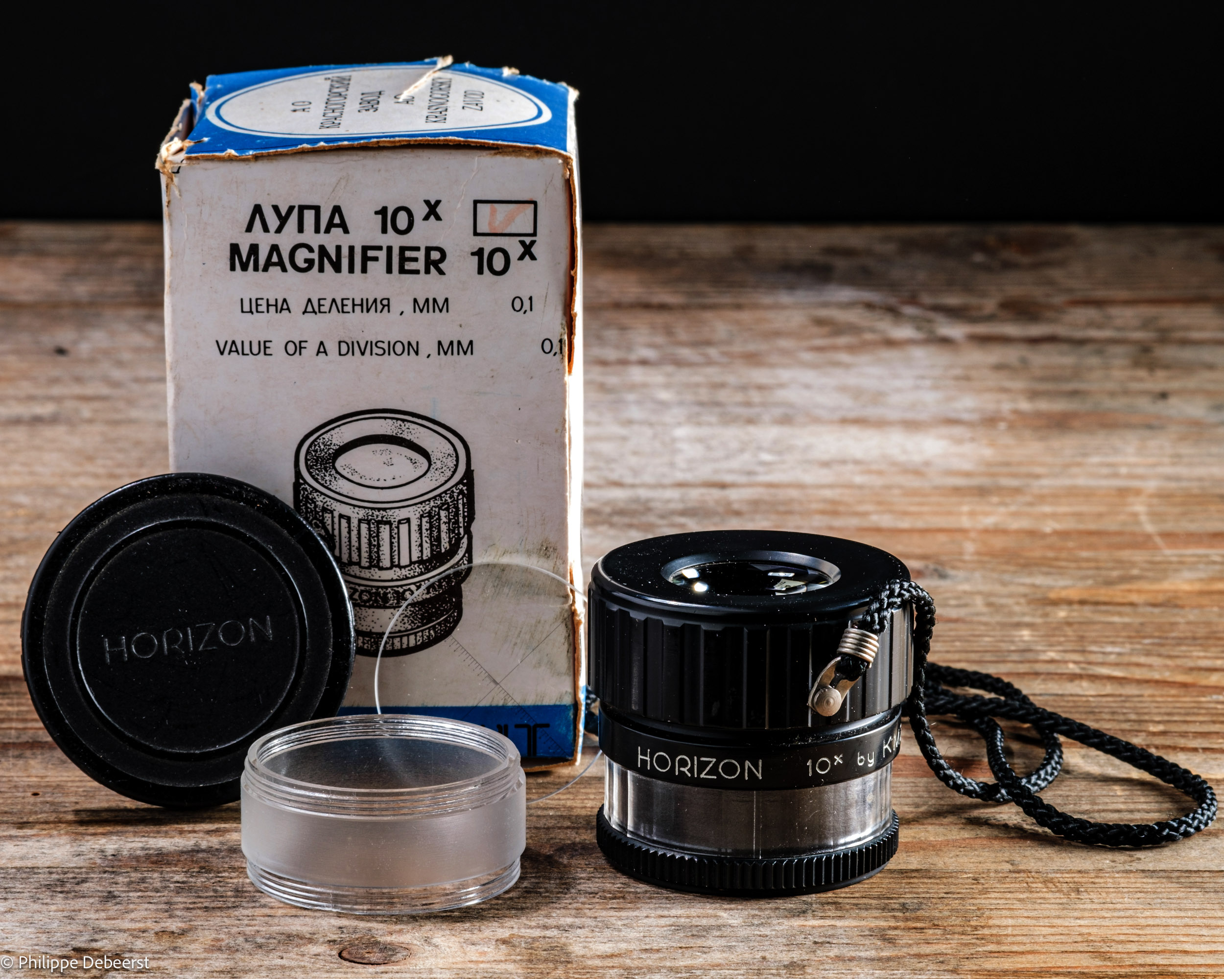

Here are my two loupes
So far have not need anything more fancy. Usually they do the job for my Caltar 65mm F/8 which is the one I find harder to focus.
