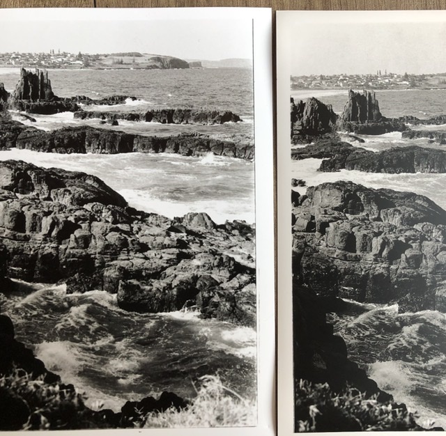

The image on the left is on the one I’m having trouble with. Both done using the same focus finder and both look perfect through the focus finder. Hopefully the difference is noticeable here.

Thanks for all your replies everybody! Ok so after reading through all the above I don't think I've found the problem. The problem is very strange and may be a bit hard to describe. So basically, on the AGFA C66 (Durst M605) I'm having the focusing issue. So last night I went and tried some of these suggestions and no luck.
So what's happening is I focus on the grain with the focus finder perfectly, it looks tack sharp, I can focus on the grain easily. Then, instantly when I look at the easel, it's clearly not in focus. I'm not leaning on the focus wheel or anything like that, I'm focusing on the grain then pulling my hands away, looks perfect, lift my head and move the focus finder from the easel and I can clearly see I'm out. I've tried two different focus finders and they both do the same thing.
I've got another enlarger though and when I use the same focus finders on it they work perfectly.
I've tried paper on, paper off, adjusting the eyepiece, tried focusing both wide open and at the aperture used, nothing seems to work.
If I focus the AGFA by eye I get better results than with the focus finders. As suggested, why don't I just focus by eye then? Well it's better focus but not perfect, I feel like I can only get it so sharp by eye.
