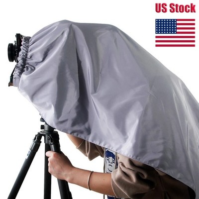

When I jumped to 8x10 I bought one of the lightweight focusing cloths off of ebay. I think it's an eTone brand. I had done a brief search for goretex and the like and couldn't get the pieces of fabric for less than I paid for a finished product.
