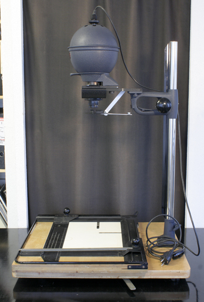

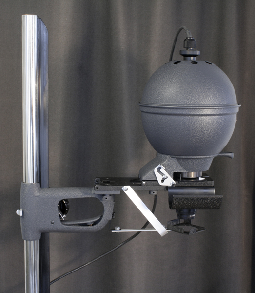

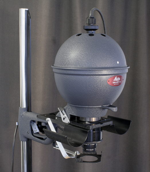

Ok, here pictures of how I extend the arm of the Valoy II.
For years it bothered me that with this beautiful, simple enlarger it was so difficult to print large with an easel. Even when you turn the column around, the enlarger head still sits too close to the column. Someone posted in another forum his solution to do this (using plywood, if I remember correctly), and this inspired me to do it too.
I used a part from another Valoy II, which was incomplete and I always kept it for this reason. The part I used is the metal rectangular plate on which the enlarger head rests. All I needed to do was to drill two holes in the second plate, to use the original fixing screws. Once I figured this out, it was quick and easy. It's all fixed solid. I am not at all a skilled technical person, so really anyone can do this.
I also changed the baseboard to a Focomat 1C baseboard, the larger version with the locking hardware for the Leitz easel. It works fine, but perhaps the board is a little too large. It would be worth the effort to find out how the smaller Focomat 1C baseboard fits. Finally, as I use the filter holder for the multigrade filters, I had to extend this as well . . I think the pictures will make it clear.
The actual distance of this extension is 9cm (3.54 inch). I had little choice there. It brought the lens to the same distance from the column as with the Focomat 1C.
One could argue why go through so much trouble when the Focomat 1C is the obvious solution and to an extent this is so. Let's say I wanted to find out if this Valoy II has it's own character, when doing the same size prints as I do with the 1C (mostly 20X24 and 16X20). Can't answer that yet, because it will take many negatives to get that clear.

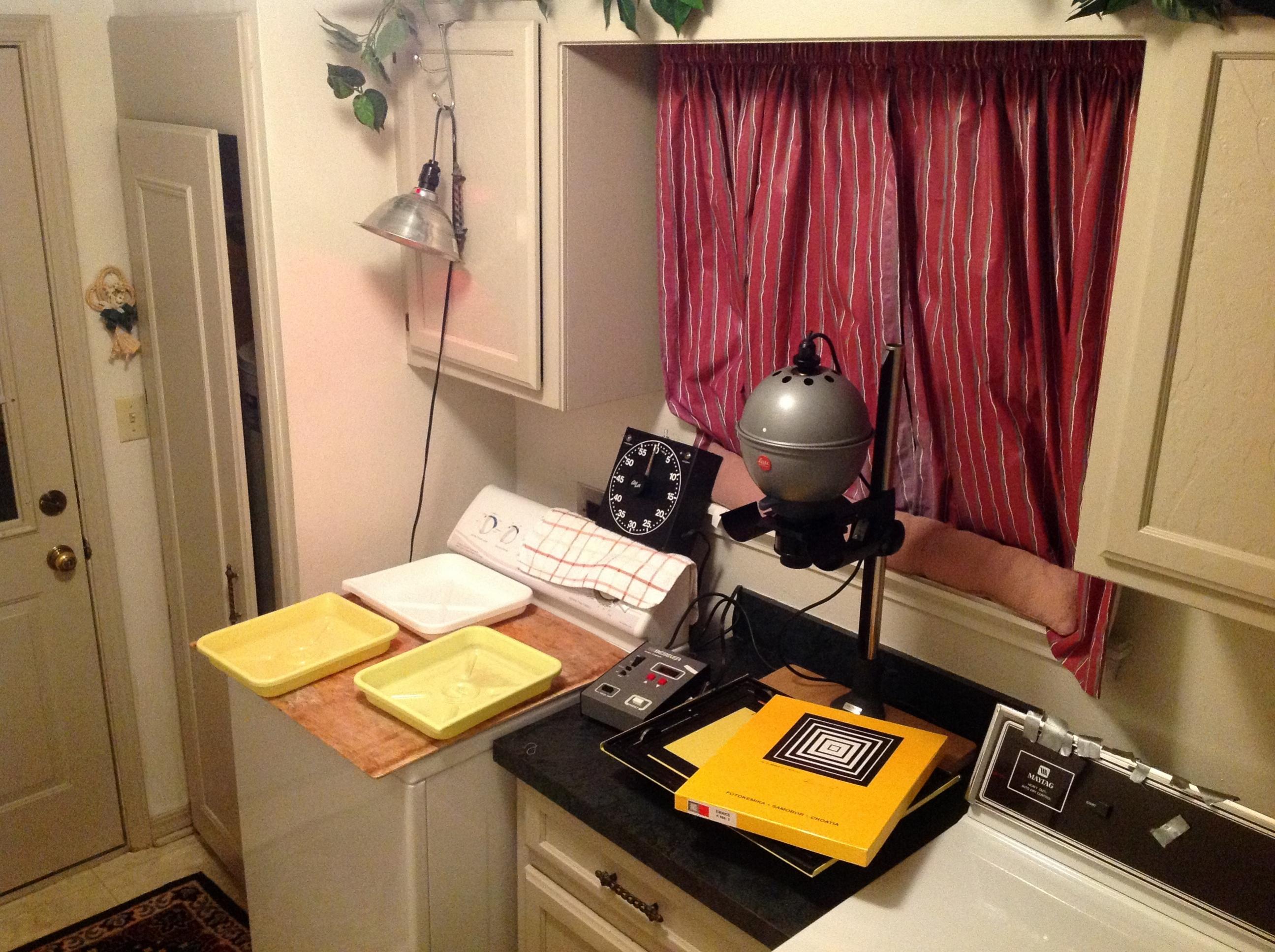

The picture shows my dry DR. It is amazing how photographers appropriate space and make it work.
