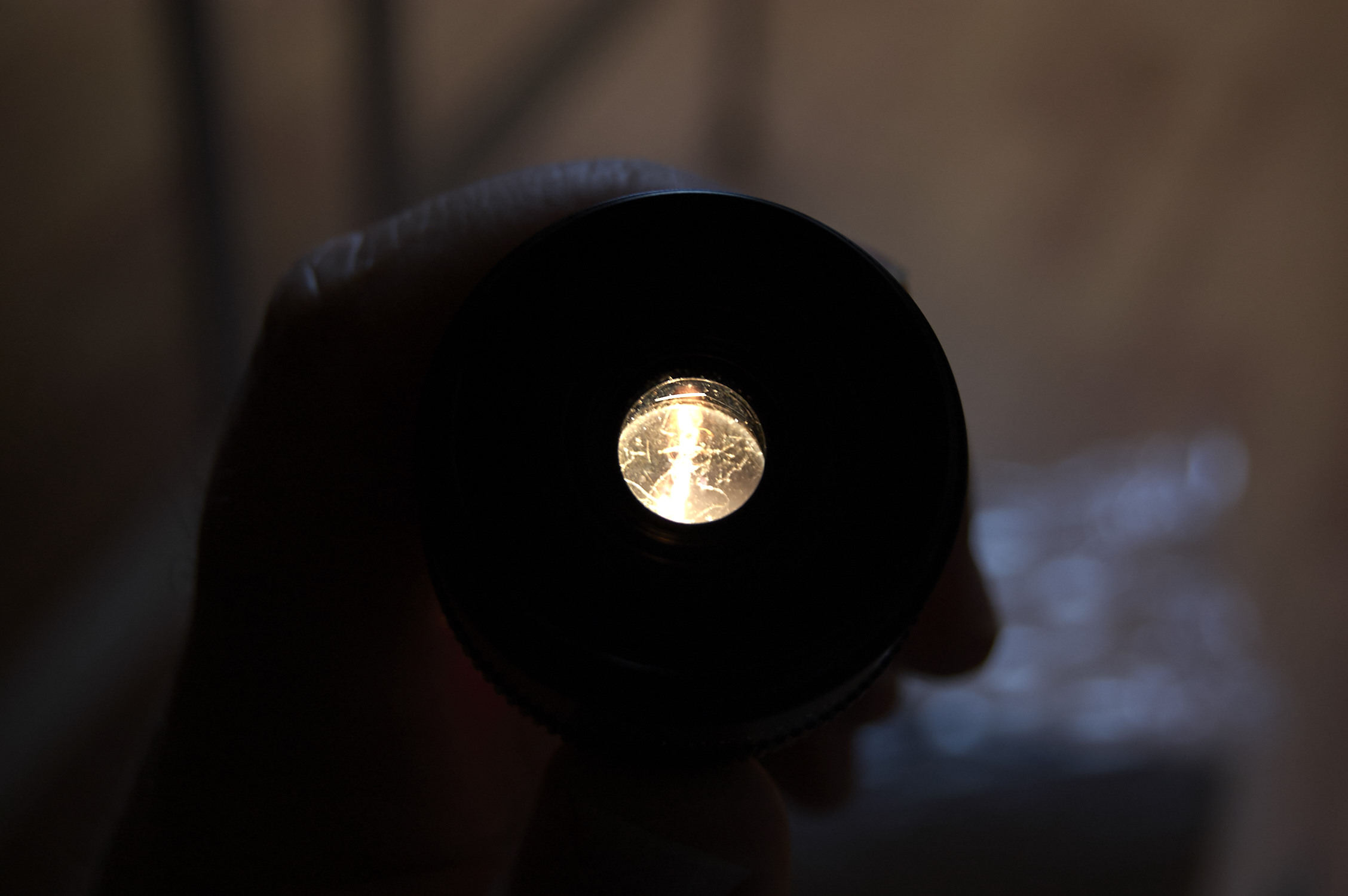

Today I got the Focotar-2 back from Leica service. Nice boxes, certificates, etc. And the lens is clean as a whistle. On the outside. Which of course, was how I sent it to Leica. The inside remains UNTOUCHED. I bet it wasn't even opened (no marks anyways).
WTF!???
I'm really disappointed and angry (mostly about myself) that I was so deluded to believe that Leica would provide quality work on this and I fell for the scam (I should know better, quality, honesty and workmanship in german companies is a thing of the past). It looks like they cleaned the outside surfaces at most (honestly I looks more like it has been dusted off and put in a fancy box) and that's it. At least its not damaged like my other lenses I sent to one of those "gurus".
Now within 3 months I've managed to invest 600 bucks into destroying 3 of my best EL-lenses and have the barrel of the 4th cleaned with a Leica certificate. Well done Andi.

That is a shame. Maybe it was etched and they couldn't really clean it? If that was the case, they should have told you before going ahead with it.
I would have probably sold you mine for 2 bills. Kinda feel sad for you.
Thanks PRJ. I fell victim to my own naiveté i guess.
Yes it's a possibility that it has been etched and they could not clean it. They did not tell me neither before nor after. After assessing the lens, the estimate included details of the work they're going to perform. It also said that a very faint mist may remain. And that's fine with me, most older lenses have that. I didn't have high expectations but I was expecting at least some improvement. Now I feel like i've been conned (I haven't been, as I signed off the paragraph to exclude any warranty on the work, just feels that way anyways).

So I tried a little DIY lens tinkering on a spare Focotar-1 today that would have needed cleaning anyways. Sweet fancy moses, I'm no slouch in fixing things. But that thing... I broke my spanner inserts during that operation. A heavy duty spanner, not the small ones. I could not open the inner ring, no matter what I tried. It must have been glued to the thread or something. The outer ring which holds the outer casing of the barrel was easy. This inner ring... impossible. I slipped once and now it looks ... ugly.
I can only imagine the -2 been similarly sealed and the reason Leica did not open it. The rings and threads would probably have been destroyed or at least scratched a fair bit. And they said they have no spare parts for Focotars anymore. Surely they would not send back a lens with broken threads, so the only option is doing what can be done without breaking it open and send it back...
Anyways, I've sent it out to Fototechnik Langer, see what he can do. In the end its probably best to look for a mint one in the first place.
