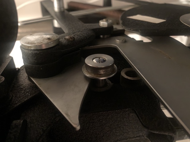

- The newer and excellent 50 focotars (without the 17675/DOORX extension tube) will work on the Focomat IIa and will focus throughout the magnification range. For this, all you have to do is to insert the focus pin so the focus blades will lie on the thinnest part of the pin. (See pictures).
-For the Focotar-2 100mm, keep the pin as stated above. It will focus throughout the entire magnification range.
-the excellent focotar 60mm will also work, but it will have to be fitted with the extension tube 17675/DOORX, and be used with the Pin as stated above, inserted for the focus 50mm setting.
Also, I believe the Schneider Componon 50 and 100 shall fit, but I won’t buy them since I own the lenses above.
So there it is, the Focomat IIa has now become the IIc-minus.
Photos in the next post.
In the first picture, the pin is inserted as to provide autofocus with the native lenses (bad performers) and prevents any other (excellent focotars) to be used.
In the second picture, the pin is inserted as for the focomat IIa as to accept any and all other focotar lenses. But cancels accurate autofocus. However, you gain the best image quality.
Voila.
Last update,
For the use of 50/60mm focotars, it is best that you just take out the pin. Keeping it inserted as shown, it will get in the way if the lower Focus blade if/when enlarging quite big (16x20).
Taking off the pin completely solves the problem.

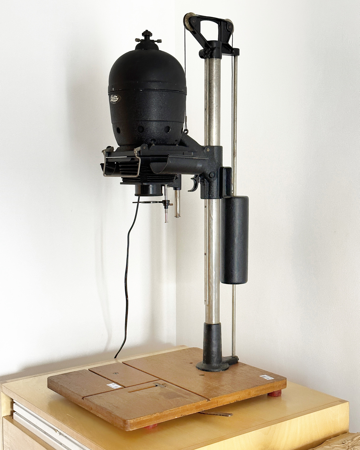

Hi all. Just thought you might be interested in my latest Leitz enlarger: a 1930s vintage Vasex I. It’s the manual focus Valoy style precursor of the Focomat IIa. Actually they may have been contemporaries but the key thing about this machine, besides being an exquisite thing, is that it works with all sorts of lenses and no AF cam to worry about. I’d be interested to compare notes with anyone with Vasex experience. Especially the larger ‘trade darkroom’ version II.

Congrats on this purchase! I considered bidding for this Vasex, but then decided not to do so. Too much of a hassle to bring it to where I live.
There were two reasons I was interested besides the reason you already gave us (the single non automatic lens construction).

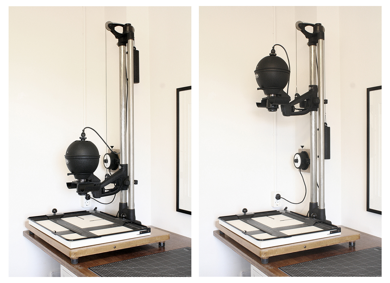

First because of the counter weight, which is not unlike the Reprovit II's counterweight. I have a simmilar setup with a Leitz made solution to use the Valoy II attached to the Reprovit II. I love that counter weight, it is like an old elevator in a Hitchcock movie.
Second because I found a special lamphead for the Vasex enlargers. Which is a lamphead with four (yes 4!) bulbs that was used when printing glass plates. I never got that to work in the more recent Leitz enlargers.
I may know someone who has the Vasex 1 as well. Let me check.
Here 2 pictures of the Valoy II and Reprovit II setup

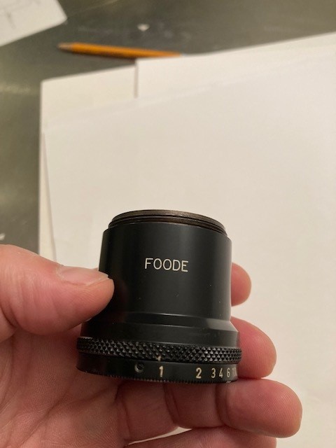

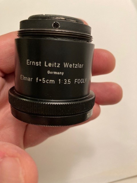

The lenses on my non-color IIA are FOODE 95cm 1:4.5, and Elmar FOOLY 5 cm 1:3.5. I find the FOODE excellent. I never could figure out how to use other 50mm lenses, which is why I picked up a 1C for 35mm...never used autofocus anyway...thanks for the pin tip. Does that work for both cams or just the 50mm?
