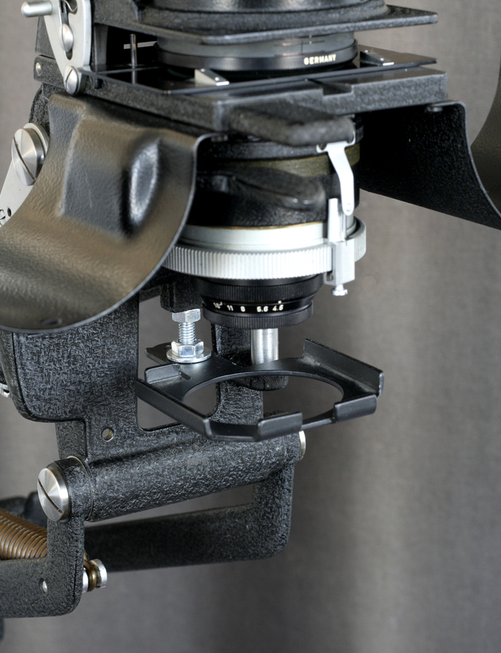

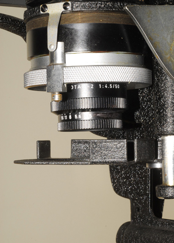

Yes, my usual struggle with words . . . I should have mentioned that on the pin rests the foot of the paralellogram. When you use the 3cm thick easel, you move up the paralellogram 3cm (by placing the pin in the high position) for the autofocus to keep being precise.
With regards to a filterholder, yes it is not difficult to make something once you see the redfilter. I attach some pics, first the Leitz made holder, second a Beseler holder (I believe from the 23C), both do the same
