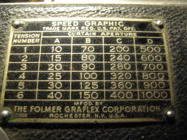

My SG shutter goes down to 1/10th second - However, I make an assumption that the smallest slit should be set with the slowest tension - (Aperture D with Tension 1 = 1/500th sec) I have found the SG shutter to be fairly accurate

When governed by tension and slit width like on a 5x4 Speed Graphic a horizontal edge of the shutter curtain slit takes just over 1/10th of a second to cross the film plane at the minimum tension #1, yet with the narrowest slit width this gives a shutter speed of 1/350th. So there's a time lag of 1/10th between the exposure at the top and at the botton, slightly longer if a wider slit is used.
Even at the top speed of 1/1000 which is at the maximum tension #6 there's a lag of 1/35th of a second.
