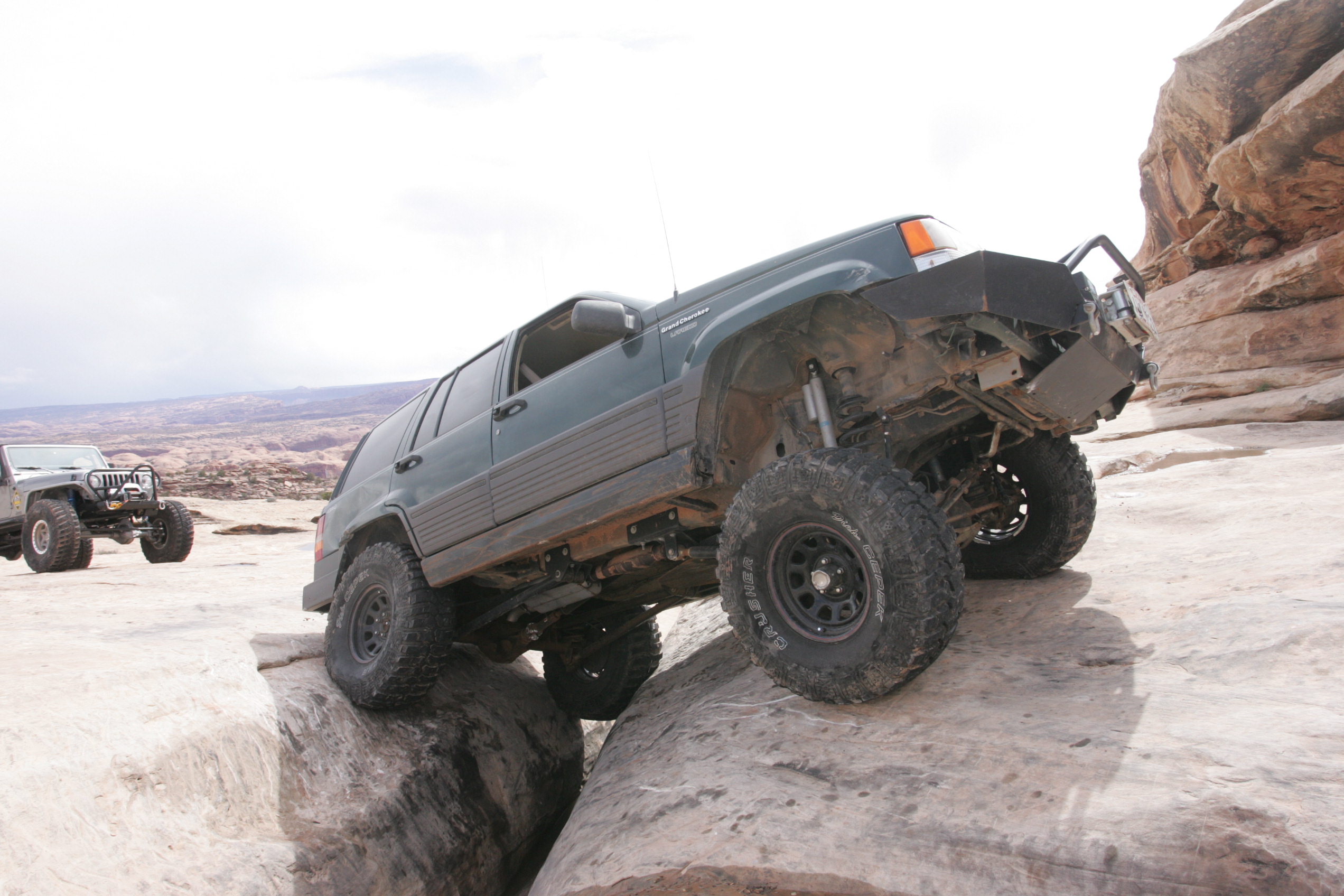

The wheels on the old cars were a lot bigger, too - don't expect the same degree of distortion on a modern car going at the same speed, even when the slit travel time is the same.
Well I do have 35" tires ... will those be large enough?
Sirius Glass
Jan 18, 2007
50,864
Southern California
The only thing to shoot that monstrosity with is a 40mm quad Bofors.:smile:
I need someone to use my 38mm Hasselblad 903 SWC to take a photograph at that location with the Jeep completely filling the frame.
Anyone interested in a road trip to Moab?
