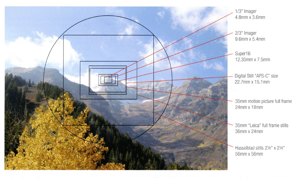

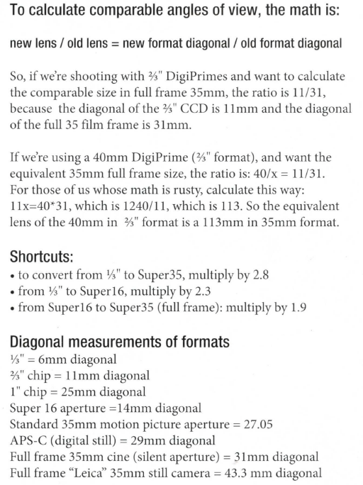

The following were clipped from an article on focal lengths from the Jan 2007 issue of Film & Digital Times.

This may have already been said, as I didn't read every post, but, the only change when using the same focal length on different formats is what has become known as the 'crop factor'.
I know portraits have been the main subject of this thread, but think of it in macro terms (it's a portrait of something small). If I use a 100mm macro lens at 1:1 on a 35mm camera, and take a photo of an object that is 3 inches by 4 inches, it will fill the frame. What is on the frame will be a 1:1 reproduction of that part of the subject that is 24mm x 36mm. If I then use a 100mm macro on a 6x7 at 1:1, I'll get a 1:1 image of a 6cm x 7cm area of the subject from the same distance. Move to 4x5, and now it doesn't fill the frame at 1:1, so I'll get an image of the full object at a 1:1 magnification, but I'll also get a half inch of background around the subject. But in every case, I was at the same distance, and I got the same magnification (which can be said to be the AoV), but I got different looking images, only because the different sized negatives allowed capture of additional areas because of it's size.
If you take a 150mm lens from a 4x5, and mount it to a 35mm, the only difference in the image will be how loose (on the 4x5) and how tight (on the 35mm) the crop is. If you did that, and took the 35mm negative, you can place it on the 4x5 negative, and everything will match perfectly, because the lens had no idea what format it's projecting on to, so it will always project the same image, with the same compression, the same dof, the same aov, onto the film.
