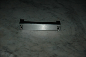

Can we see what one looks like now?

I don't think digital photographs of your coating blade should be a problem here at APUG since you aren't posting them in the galleries. Besides all images here at APUG are digital anyway.
My 2 cents,
Don Bryant
Ole
Sep 9, 2002
9,245
Bergen, Norway
Speaking as a moderator, a digital representation of an analog product is - well, what APUG is about, really!
A picture in a thread to explain what the blades look like is not only acceptable, it's most appropriate.
Besides, I want to see what it looks like :smile:

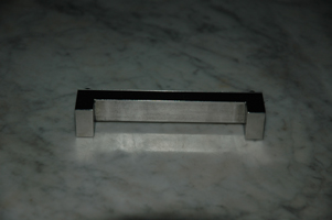

Prototype Film blade
Ok then, here are two pictures of a prototype film blade. It makes 2 4x5 coated areas on one piece of 5" x 12" film and uses 6 ml of solution to coat that area when gapped at 5 mil.
This is the first anyone on the internet is seeing these.
Sorry for the flare from the flash, but it is rather dark here and the blades are highly polished.
