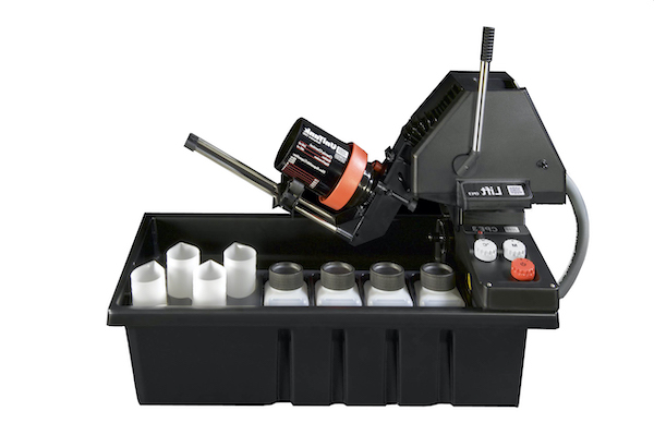

Apologies if I picked the wrong forum to ask this question, but I couldn't find anything more appropriate. I am thinking about getting a CPE-3 with a fork lift. I think my volume is about perfect, as I usually develop 4 rolls at a time, and it's borderline acceptable for manual dance with Patersons, but gets quite annoying if all 4 are different films.
However...
My laundry room is designed with the sink on the right (wrong) side. Is this possible to assemble CPE-3 in a "flipped" orientation, i.e. like this:
Pretty sure the CPE-3 is molded to be configured only one way...
Exchange the outlet tube for a stiff tube going by means of two 90° pieces behind the processor to the sink. There by means of two furher 90° pieces you yield an outlet you can place your bottles under.

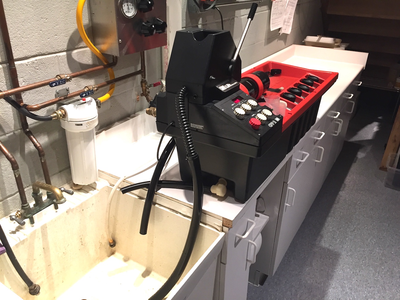

I'd consider using longer hoses and run them behind the unit to the right.
If he just uses a longer hose he likely will no longer be able to place a bottle under under its end as in the original state. That is why I proposed rigid tubes.
