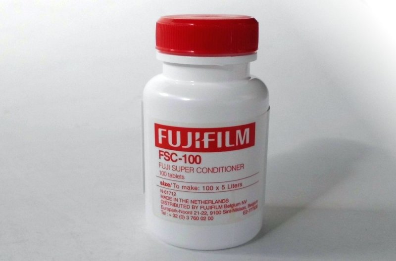

Those pills look interesting, though I don’t see that they contain formalin. Would they accomplish the same purpose more safely?
Obviously it would be nice not having to deal with formalin at all, but I’d like to know that my negatives are going to stick around for a while without going bad. Or maybe a raw file from a scanner is the really the only way to preserve these older films :wondering:
