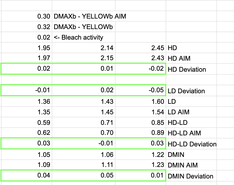

Here's the full reading from the last run of today:
This was with 4 rolls of 36 exposure and 1 control strip and 600ml of developer entering the tank at 39.5C. I suspect that I accidentally got an extra mL or two of part A in this particular 600mL batch, as my DMIN is right at control limits and my LD is skirting action limits. I could probably also bump an extra mL of starter in to pull the HD-LD red and blue down a smidge.
The only downside to doing things in smaller batches is you have to be a lot more precise with measuring out the parts.
Mr Bill
Aug 22, 2006
1,515
Thanks for the full set of example data.
Adrian, when you first posted the HD-LD it didn't look right to me, knowing that that was processed with a limited amount of developer. So from my point of view, having just estimated the Br (restrainer) levels for an "average" roll, I would not expect the plot to be so close to aim. (At 0, 4, 0, they're closer than most well-controlled processes.) With the bromide levels running 15-20% high (at the tail end of processing) the control strip plots ought to be appreciably lower. But this is possibly explained by having the elevated starting temperature; even though it falls back into spec after a minute there could still be a considerable effect.
But now, seeing all the numbers, it's pretty clear that they're not Status M. (I presume you're trying to derive them from scanner data, which cannot legitimately be done, at least not without prior knowledge about the spectral characteristics of everything.)
The things that immediately stick out are the very high numbers for Dmin (clear film). A typical Kodak pro color neg film would have densities of roughly: Red = 0.20, Green = 0.65, and Blue = 0.85. Whereas yours are all substantially higher, above 1.00. Now, it's certainly possible to have something go wrong with the process, producing a high base stain level. But getting those same numbers (above 1.00) on a Kodak reference strip, the one actual processed by Kodak, is near-certain evidence of incorrect readings.
Of course you can still use the data for "process control," seeing it as a statistical process, etc. But I wouldn't be so sure that it's giving you a clear picture of Kodak spec limits; I suspect that the differences are being minimized.
the readings are not nulled out, so the base fog is relative. That should be obvious given that the reference control strip readings (DMIN AIM) are also high. The readings that say AIM are readings from the supplied reference strip plus the correction factors supplied with that batch of control strips. Is it status M? No, it’s not. I’m working with what I’ve got. I’ve been on the hunt for a good color density meter for a while. All I can say is that the state of the film processing industry is in shambles and quality equipment is either not that abundant, or prohibitively expensive. So... I make do and work with what I’ve got. I can tell you that in an effort to validate my own process, I’ve sent very carefully constructed test rolls to a fair number of labs here in the US and can say with a pretty high level of certainty that a significant number of labs running today most certainly are not doing any monitoring of any kind as the results I got back varied wildly. I’m not going to name names as that was a snapshot in time and my intent is not to name and shame, but to just simply point out that the state of the industry is not what it was at its height.
all that aside, let’s get to the heart of the matter... I’m processing 4 rolls of film with 600ml of 1 shot developer. That gives me 150mL of developer per roll. Given that the replenishment rate per roll in a replenished system is quite a bit lower than that, I’m not sure what the source of heartburn is. Please enlighten me.
Process control/ calibration certainly isn't being helped by X-rite having decided to stop selling the requisite transmissive calibration test step tablet. And I've found that running similar quantities of film (25xx drum, 650ml chemistry) definitely gets Portra 800 more in line with where it should be than some labs (running dip/ dunk machines) that clearly aren't replenishing correctly for faster films.
I also suspect that Kodak may have built in a 100% margin of safety in their single-shot capacity recommendations - as it was probable that a great many owners/ users of rotary developing systems weren't going to be buying colour densitometers to run a process that Kodak wanted to keep relatively straightforward to do. Be careful with extrapolating minimum solution volume from replenishment rates - for example compare Xtol's replenishment rate: minimum solution per 80 sq in of film to D-76's replenishment rate: minimum solution per 80 sq in of film (note that T-Max demands a higher replenishment rate in D-76) & it rapidly becomes apparent how complex the whole replenishment thing is.
It's mainly just an interesting puzzle to me, how your system is working. But like I said earlier you put me in an awkward position; since your earlier post seems contrary to what I had just said (~150 ml/"roll" should have a measurable reduction in developer activity), if I don't respond I may be seen as conceding the point. Now, since I have personal knowledge that C-41 developer is pretty sensitive to development byproducts I'm pretty confident in what I had posited, although it was sort of a "back of the envelope" sort of thing, and it's possible that I could have been completely off on my estimate.
Plus I was curious as to how you could possibly have control strips plotting so well, essentially right on the money. Anyway, I think that the elevated starting temperature explains a lot of this.
I wouldn’t be surprised if 150mL per roll is right on the ragged edge of minimum developer for most emulsions, and potentially not enough if I had 4 rolls of 400/800 speed, or 4 rolls of heavily exposed film. I say this because I have noticed a very marked difference in appearance and smell of the used developer at the end of the run on the times I’ve done 5/6 rolls per batch.
in terms of the starting temperature, you’d be amazed how much heat you lose in a jobo through the simple act of taking the tank off the machine so you can pour in the developer, then pouring in the developer and putting the tank back on the machine. It sounds really high at first blush, but a lot of that heat is totally sucked out just by doing that alone. It’s even worse if you have a jobo with a lift system as none of the channels that you pour the chemistry through are heated, so you lose a huge amount of heat just getting the chemistry through the channels in the lift before it’s even entered the tank. In terms of temperature management, using a jobo is nothing like processing with other systems. The number one problem is making sure you have enough heat going in as you lose a lot of it just getting the chemistry into the tank.
