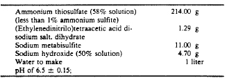

Heinz Anderle posted Fuji's E6 formulas here. Photo Engineer posted Kodak's C-41 formulas here. Kodak's C-41 fixer uses about 124 g/l ( = 214 g * 58%) pure Ammonium Thiosulfate, whereas Fuji's E-6 fixer uses 80 g/l, that's a bit more concentrated that a 1:1 dilution of Kodak's C-41 fixer. This would suggest, that you should use the Flexicolor fixer only at 1+6 or 1+7 for E6 work.
thanks. ill give it a try with an older roll of 35mm velvia and see what i get.
