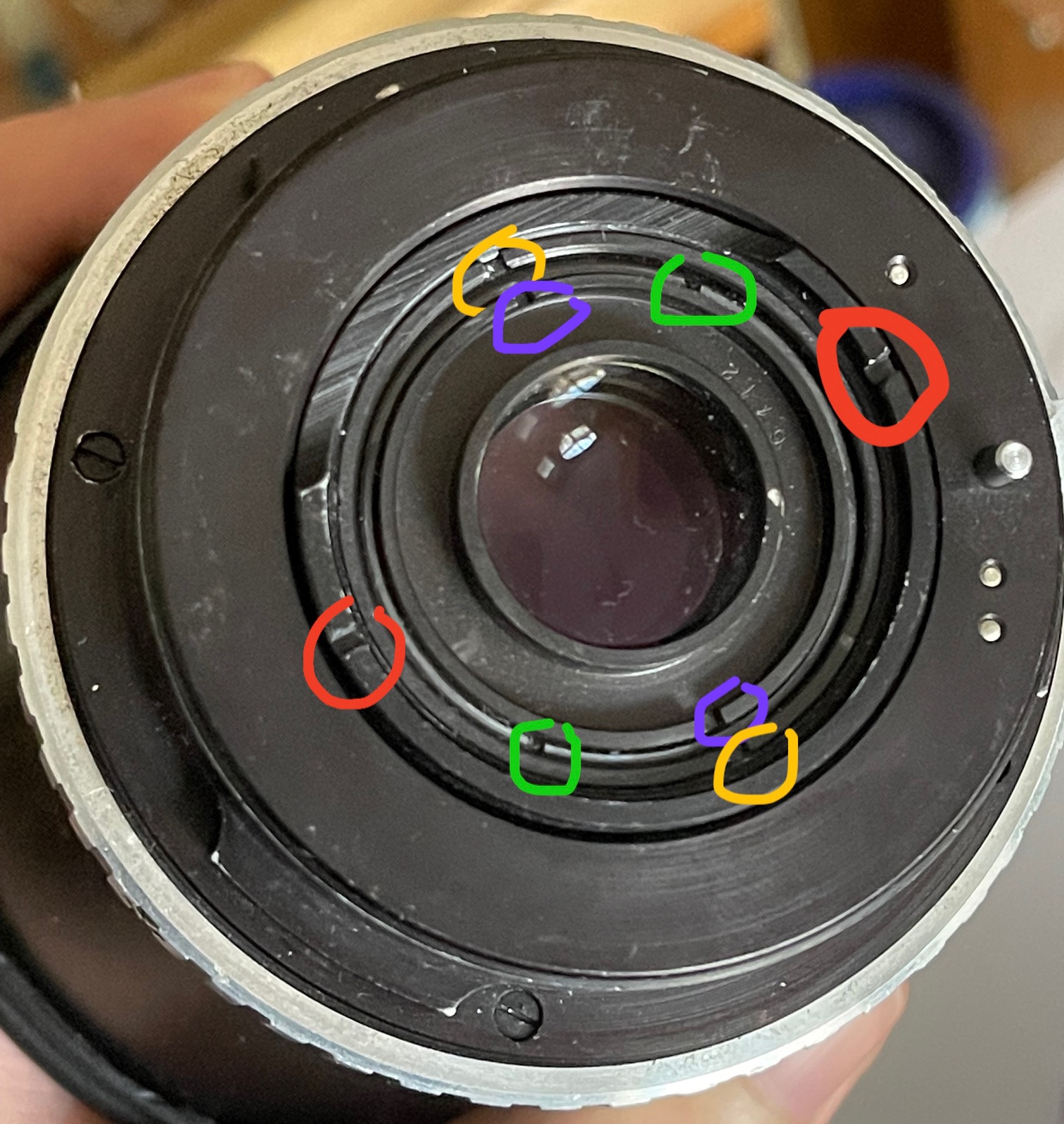

Thanks for the reply. Do you know which of the four rings I should loosen to remove the rear lens group?
I believe it is the yellow ring.
But in my case, I have the MC version which might be slightly different from yours mechanically. In addition, I removed the mount and aperture ring (be careful with tiny ball bearing and spring for aperture click stops) as well.
Also if you can remove the front group, that might be better since you can access the aperture blades from both sides. It only needs a friction cup to remove the beauty ring (where there is the lens name) first, and then the slotted wrench can get the whole front group off.
