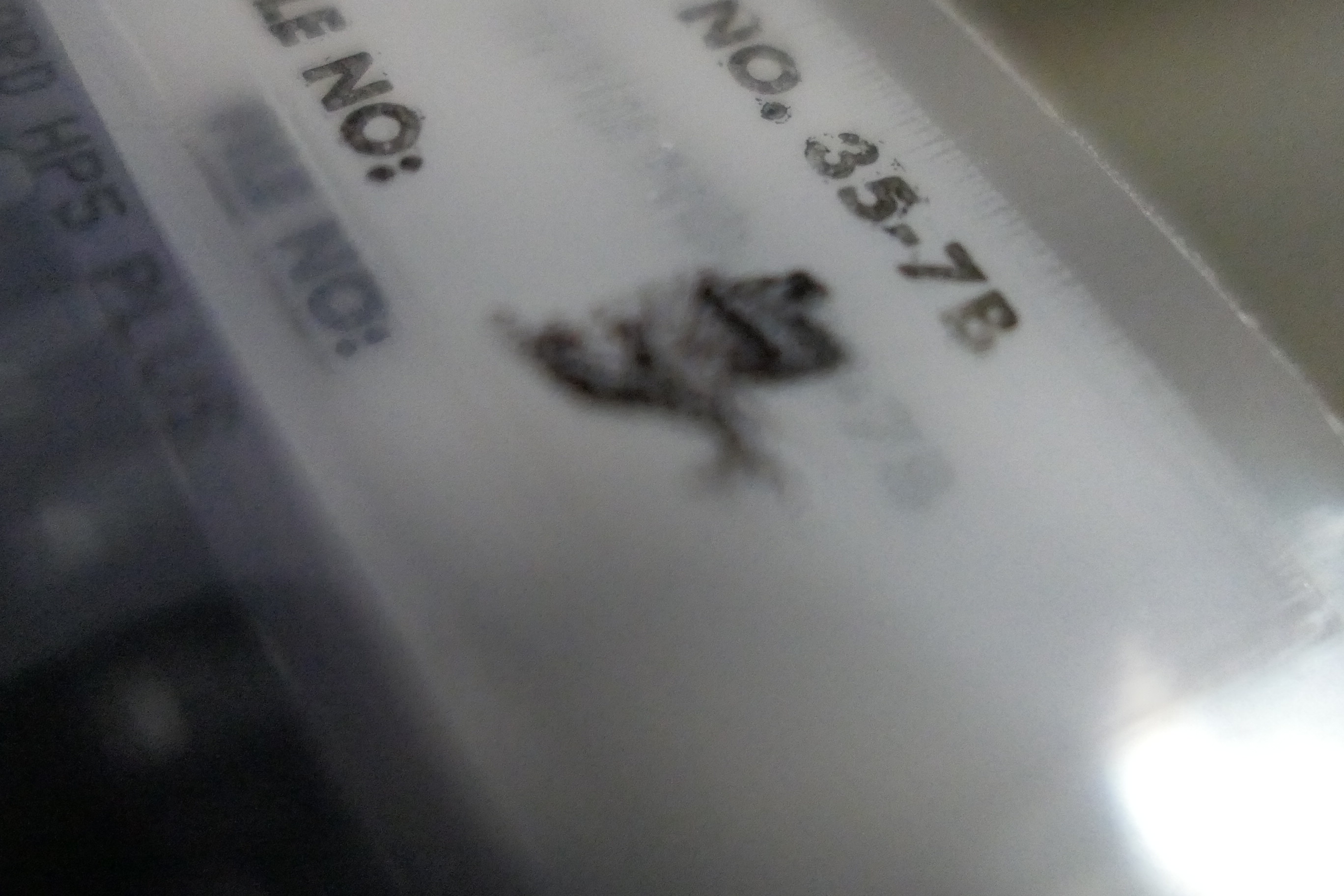

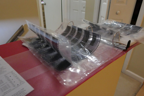

So after developing two rolls recently I wound them back up in their little black bottles for a few weeks before cutting them up into strips for binder sleeves. Now the 5-frame strips are VERY curled and make a mess of the sleeves and even makes it difficult to properly fit into my enlarger's negative carrier. (see picture 1). I tried squeezing them between pages of the heaviest book I have which itself had the second heaviest book I have stacked on top of it and left that way for two weeks. Doesn't seem any flatter. :unsure:
Any suggestions?
Also My attempts to label the sleeves leaves a lot of smudges (picture 2, which was originally a 5). What should I use instead?

One possibility might be to roll up the film with the sides reversed (emulsion out vs in) and let them sit for a few days, a week or whatever. Only thing is, that would be easier before you cut the film into short strips. I suspect that behavior varies a lot between film types. I normally cut mine from the film shortly after it has dried hanging vertically with a weight on the end. My experience is that any residual curl following that goes away after some time in the sleeves. Note too that humidity conditions will have some effect on curl.
I generally use either a fine Sharpie pen or a black ballpoint to write on the binder page. The Sharpie ink doesn't dry instantly, but it generally works OK. Ballpoint inks vary a lot -- might take some experimenting. The other pen category -- "roller balls" or "gel pens" I think are too gloppy to use.
Laundry markers are good.
You can try re-humidifying the film - I don't mean soak it, just take it into the bathroom while you take a shower or something. Then take it back out and press it under a stack of large, very flat books (a whole stack, not just the heaviest book) for several days.
He means make a lot of steam.
This is the solution to make them flat.
Failing that, re-soak in water with a drop of wetting agent and then hang each strip to dry. I have, with success, dried cut neg strips by threading a paper clip through the sprocket hole at one end of the strip and another paper clip at the opposite end, opposite side sprocket hole. Then I used a clothes pegs to act as a weight on the bottom and another clothes peg to hang at the top.
Of course, don't roll them up in the first place would be better:smile:
I have found that sleeving after the negs have dried is the best solution, as has been suggested above.
