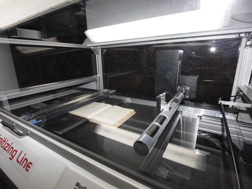

pellicle
May 25, 2006
1,175
Finland
While not practical for high-volume work, there's no reason one couldn't shoot the 8x10 in 4 or 6 or even 9 sections. 9 sections is still between 1:2 and 1:3 reproduction ratios. Pretty easy to achieve with just extension tubes (or a dedicated macro, of course).
undoubtedly ... but if I was faced with a project like this, I'd still go the flatbed. One can do anything one likes and impose any restrictions or criteria upon how to do it one wants to. I'm familiar with equipment which uses DSLR's to digitise books for instance:
, but that design may be driven as much by constraints as by "what works best"
