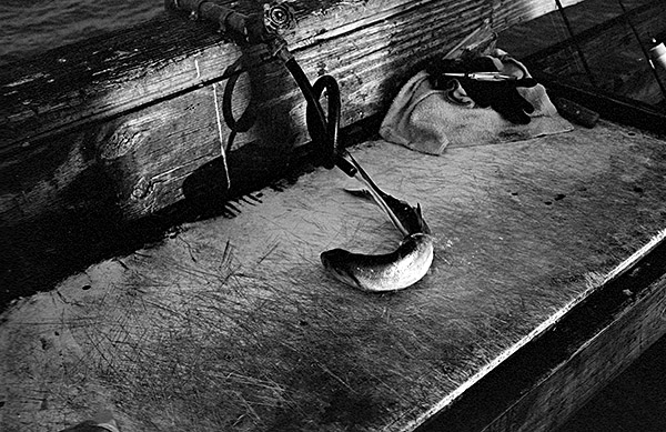

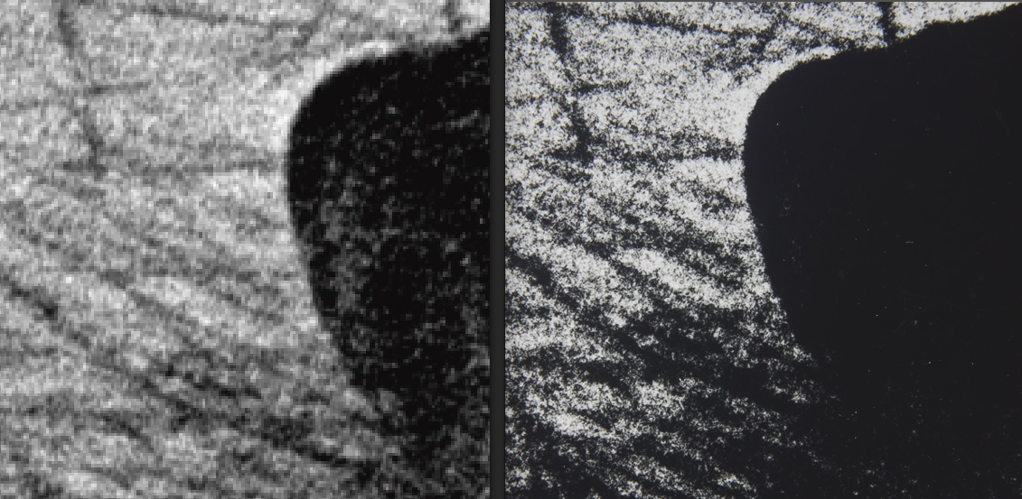

I've done the tests. Comparing a neg scanned with a Nikon 4000 that is incredibly well maintained (i.e. super clean) and a print in the darkroom. A few years ago I tested a bunch of enlarging lenses. All of them were about the same which was a surprise and no surprise really. I'll pass that info along one of these days. The tests were done on the center of the lens with my Saunders 4550 maxed out, glass carrier, laser aligned, blah blah blah. IIRC it is about a 28 to 32 inch print on the long side. I'd have to double check that, but the point is, a direct comparison was easily made with the Nikon Scanner by simply taking a couple minutes and scanning the neg.
Here is the image that I used. Not a great image, but it was sharp, the neg was fairly thin and it had detail in the center. This is Neopan 400 developed in Pyrocat shot with a Konica Hexar RF. Not sure on the lens. Probably either a Zeiss 35mm Biogon or a Pentax 50 1.4 converted to Leica M. But the film is not the finest grained film. And this is 35mm, not 120.
And here was the comparison taken from the area of the snout of the fish. The scan is on the left. I took a picture, handheld, of the print, which is on the right. What you are seeing is a screen cap from Lightroom. You can easily see the pixelization of the left image to the point of the squaring off of the groups when the right image is still tack sharp. The neg scan is falling apart, and that is a 4000 dpi scan. I left the little dust specs in the right image so you know I didn't retouch it.
Now imagine if you are using finer grained film, like Acros.
When scanners arrive at a point where I can get a result like the righthand image, I'll switch to scanning everything. Until then, no contest.
The grain on the left is not sharp. I never used Nikon scanners, but it should be able to do a better job. I used to have a Minolta 5400, which definitely showed a much sharper grain, even too sharp to my taste. The old Imacon Flextight I’m using now imho looks like your picture on the right, well not the scanner, but the scans of course. Your picture on the left looks like a scan from an Epson flatbed (I use a V700 next to my Imacon)
Having said that, I prefer a print from the wet darkroom above a print from a scan. So we agree on that. But for me that has nothing to do with quality, but with the fact that I like the whole process a lot better.
