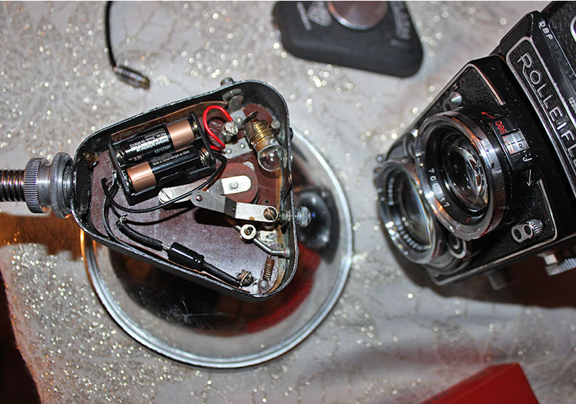

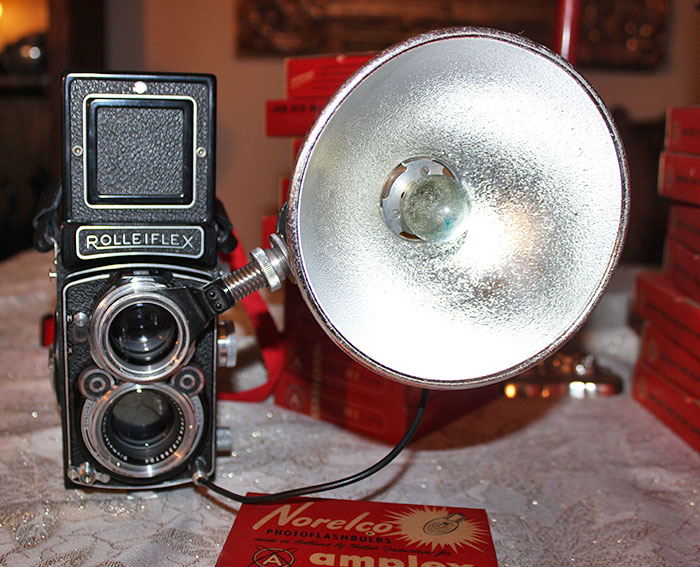

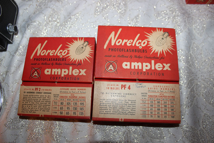

So i want to play with some old flashbulbs. I replaced the capacitor and replaced batteries with 2 12v in series so it's working. Any how I'm trying to understand these bulbs. The rollei 2.8b syncs up to 1/500 sec I have an old flash meter say I flash it roughly 12 feet away and I get a f number of 16 Would this be the peak of the bulb and would the peak of the flash. be simultaneous with a shutter speed of 1/500? Or would it be better to stick with the guide number formula on the box?

I find it better to use guide number, or one of the dial calculators in an old Kodak PhotoGuide.

Best to just use the published Guide Numbers for exposure control with flash bulbs. If you know the Guide Number for the bulb and reflector combination you are using, I can help you quickly create an accurate table of subject distances by aperture for each film you might use, at any aperture resolution you like, if those might be useful.

The package of bulbs should give guide numbers for different size reflectors and their surfaces based on the shutter speed.
