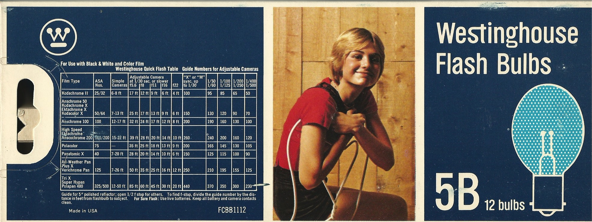

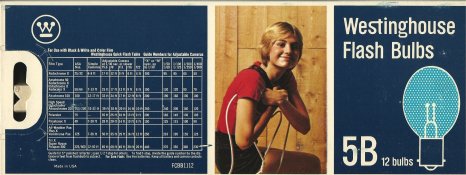

The package of bulbs should give guide numbers for different size reflectors and their surfaces based on the shutter speed.
attachment.php

One more detail: the guide numbers on the package were computed for indoor use. They assume some light bouncing off the walls and ceiling. For outdoor use or in large halls, you loose one stop of light. So in those circumstances, just use the GN for half your actual film speed.
This is documented in some of the old GE or Sylvania flashbulb brochures. And some packages also say so. I've also verified this myself by measuring the flashbulb light output outdoors with a Sekonic flash/light meter: I'm measuring almost exactly one stop less than indicated by the GN on the package.
