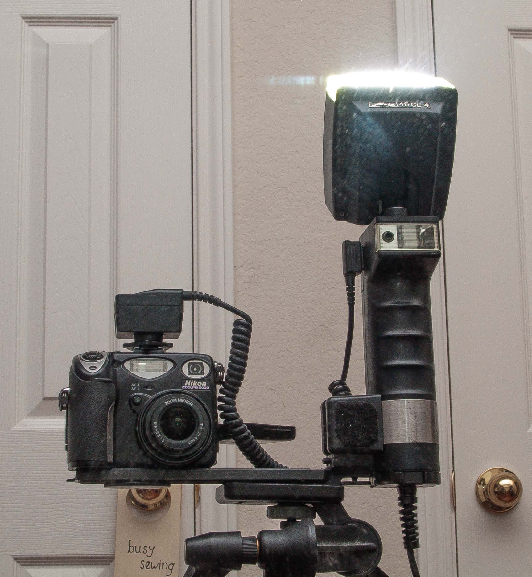

Yes I did this with the mirror
Use a mirror and just the D800. Done.
