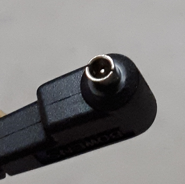

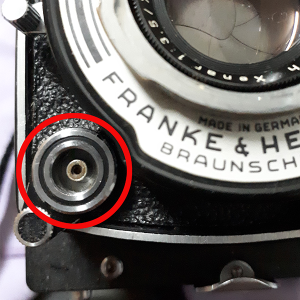

hello,
I am using rolleicord Vb and got problem.
The flash sync with Bowens flash does not work...or a very few times it works.
I have cheked the cord with multimeter and it is good. My camera has been checked also 6 months ago... and it was no problem.
Does anyone know what might be the problem?
many thanks,

How firmly does the sync cord fit the camera socket? The split outer connector of the cord can be crimped inward to make a tighter fit.
With a cord connected to the camera socket, ohm meter connected to the cord, trip the shutter on B, the meter should read less than 10 ohms.
The sync will be too fast to read on the meter at other speeds, usually its just a wiggle of the needle on an analog meter with a digit change at best on a digital meter.
Check the MXV for correct position.

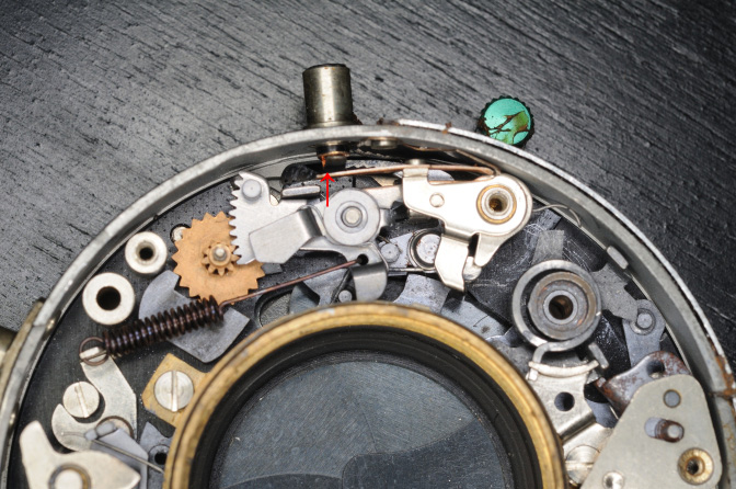

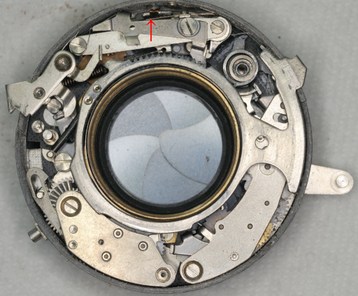

Flash sync contacts are at red arrow, second photo has the Bulb lever removed for clarity.
The sync center contact on the body is connected to the shutter via a wire that is attached via a screw socket on the shutter in place of the PC socket shown. Many cameras used the shutter with each having its own minor variation for that camera model.
If the sync cord is not the problem then the shutter will have to be serviced.

thank you so much for answering my question.
for now i did 'The split outer connector of the cord can be crimped inward to make a tighter fit.' and it worked 100% !!!
