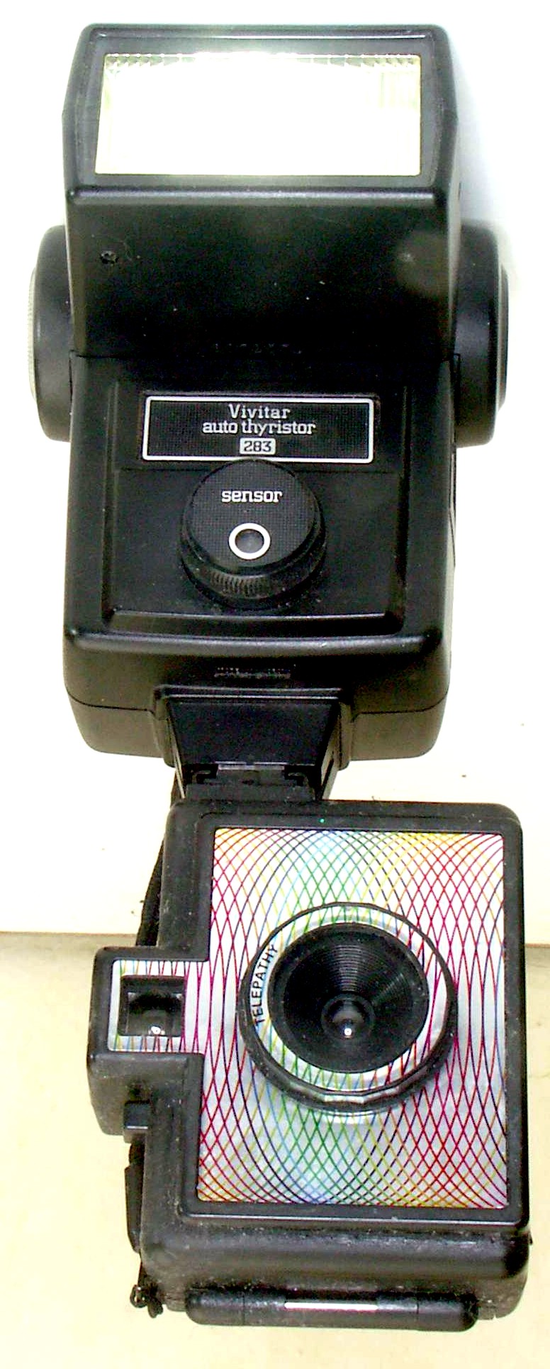

The 283/285 (and similar) flashes are large -- but powerful. That's why I asked if the OP wants ONE flash to use on ALL four cameras -- and how much power! While a 283 is big for a Trip 35, there are a ton of great small flashes with 283-type features that are much smaller and lighter (only 2 AA batteries) that have auto and manual modes and cost less than $10 used. The SUNPAK Auto 101 comes to mind as does the Minolta Auto 118X. The SUNPAK Auto 121 S is incredibly small.

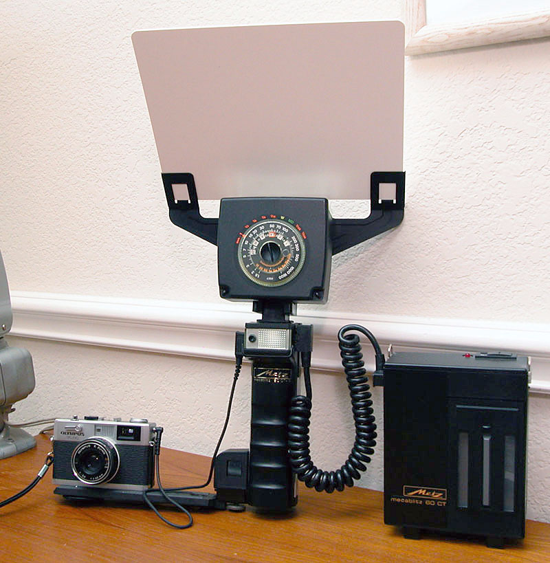

My argument is that the new flashes don't have non TTL auto flash and so it's difficult to use. Guide number is OK but that would preclude bounce flash. If you mount the flash on the stand, remote trigger it and use a flashmeter then why a small flash?
Any way I have no balance problem using the Metz 60-CT4 with the Olympus 35RC or Canonet QL17 GIII. Work great.
I fully agree that auto flash is very important, so you can set ISO/aperture and shoot away. Sadly that new flash only have manual flash output control, and it will be more complicated to calculate. A small-medium Metz flash with standard shoe and PC connection might be a better recommendation.
I can see that your setup works for you. I'm more a mobile guy when doing strobist, right hand with 35mm compact camera and wireless trigger, while the other hand holding a small flash. Or I mount a small and lightweight flash directly on the compact camera's shoe. If I were to take out the potato smasher, I might well go for the larger SLRs. But we are all different. :smile:
I know that we all need upper-body exercise, but I still try to keep my electronic flashes to the same size as the camera -- and hopefully smaller. And definitely lighter than the camera.
Here's a 283 attached to a small 35mm half-frame. Works great. It turns the very simple camera into an aperture-priority, auto-exposure WONDER camera, but I prefer a much smaller flash that has less power and the same ability.
