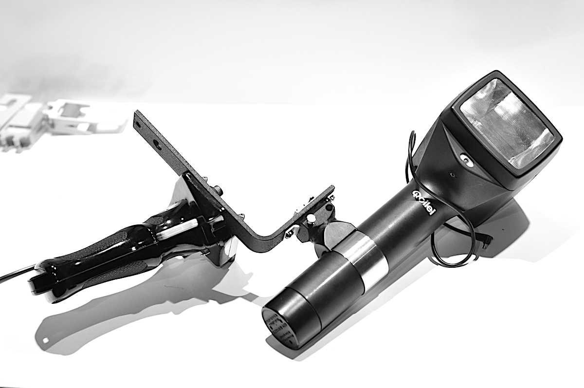

Interms of my personal experience I have multiples of each of these which I use in AUTO mode non-TTL with just about any film camera with flash contacts.
Nikon SB-28
Metz 54MZ
Rollei E36RE
The Metz 54MZ is a 'high end' late model unit and the can be expensive.
The SB-28 has almost as many features as the Metz and is easier to find.
The Rollei E36RE is a much older 'potato masher' unit that is probably only of value if one has the mechanical adapters to hold the flash to SL66, TLR Handgrip, SL3003, etc.
The SB-28 and Metz 54MZ are nice if you also DO HAVE TTL cameras as they work in both TTL and Non-TTL auto modes.
Nikon SB-28
Metz 54MZ
Rollei E36RE
The SB-28 has almost as many features ad the Metz and is easier to find.
Although the OP has no Nikon I do feel the old Nikon top of the line flash like the SB-28 is a good choice. They are as powerful as a shoe mount flash can be. Very compact for the power. Has a very good range of aperture choices. Has zoom head and also tilt and swivel. And they are cheap now
