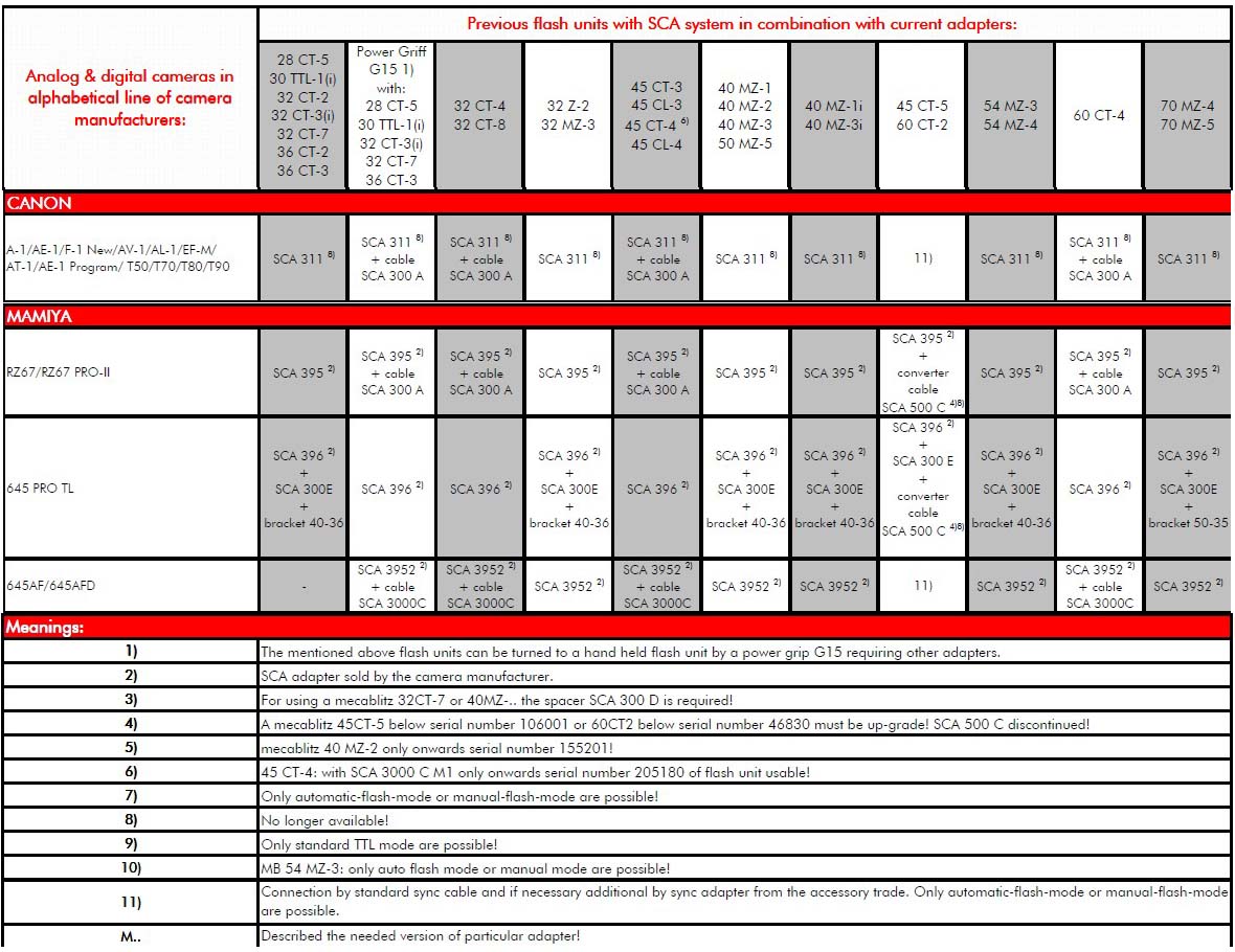

Go to http://www.metz.us/SERVICES/Catalogs/# select the complete Photo Electronics catalog and download it. On page 26 is the SCA adapter information.
Condensed from an older archive pdf I have saved on my computer that is no longer available online.

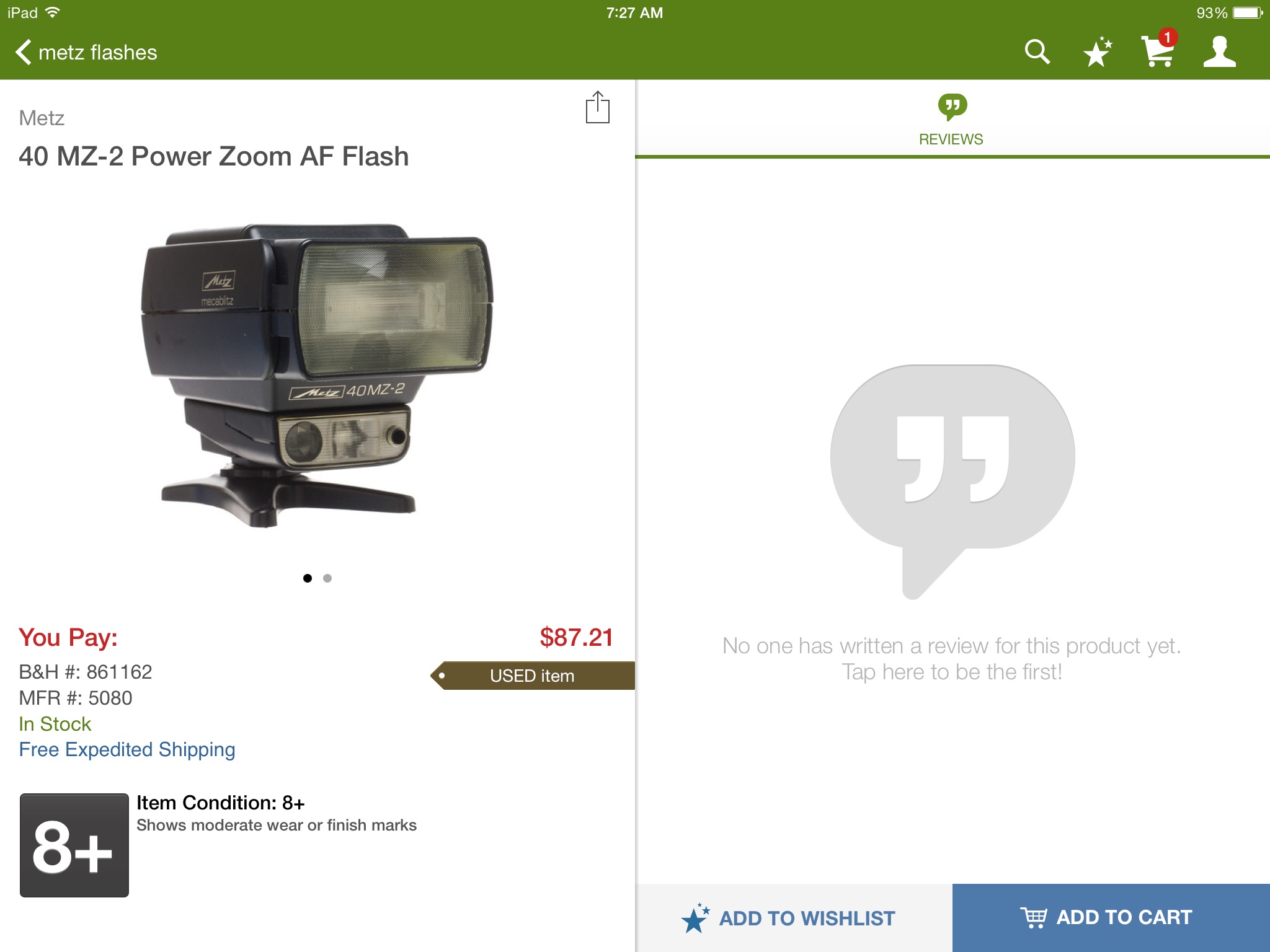

Thank you for all this information. Am I correct in assuming the following combo would work for my Mamiya 645af? This adapter, and the flash seen in the attached picture,
http://www.ebay.com/itm/Mamiya-645-AFD-AF-SCA-3951-TTL-Flash-Adapter-f-Metz-Flashes-/320810307210
attachment.php
