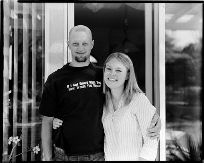

i've been trying my hand at LF portraits from time to time. i've been getting better at available light portraits, but there's only so much light you can bring in while people are holding their breath to stay still. maybe i should wall-mount some brackets for people to lean against? :smile:
anyways, i've been thinking about upgrading my flash units. i have a small novatron set, 240 Ws pack and two heads. if i pop one head through a umbrella at 5' away and 240 Ws, my meter says f/8. great for miniature format, but for LF, one of my lenses starts at f/10 (carl meyer apo process 12").
so now, thinking about format size, f-stop, and amount of light, it seems to me that i need more light power so i can stop my LF lenses further to increase the DOF.
is that correct thinking? more light -> f/<higher number> -> more depth of field?
as an aside, i'm thinking of selling my novatron set (i love it, still learning with it) to upgrade. alien bee B1600 and maybe an 800? more oomph than what i've got.
in the interest of getting more LF portraits online, i'm attaching an available light portrait i did with the above mentioned lens .. my brother and his beautiful wife.
